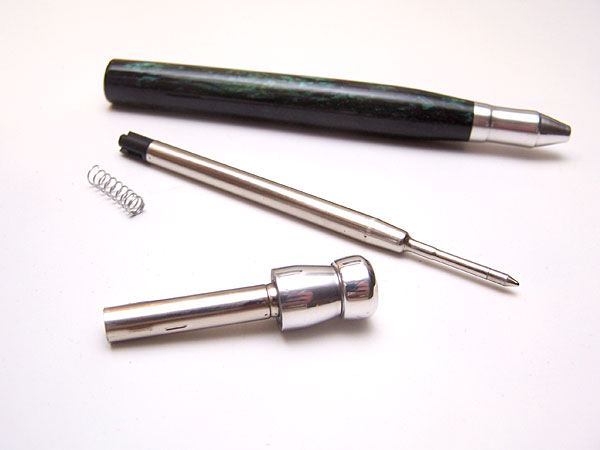

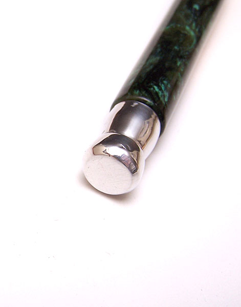

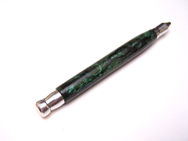

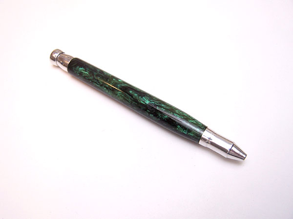

I decided on a twist pen for my first kitless, so I wouldn't have to worry about threads and such. I used a slim transmission and a pair of slim tubes. Aluminum finial and nib, "Alien Blood" PR, Parker refill. I haven't decided on a clip yet. The nib was drilled then epoxied to the tube and the combination was turned between centers.
I did learn that press fit parts don't work so good with a spring loaded refill. The finial works its way out after several uses of the transmission. I weakened the spring considerably and it helped but still isn't perfect. So I will have to incorporate threads somewhere anyway if I make more of this design.
My calipers must have moved between measuring the finial and the barrel. :rolleyes: But as this is just a design test, not a huge deal.

A simple solution to the finial slipping off , on future ones thread the nib end so it screws into the body and use a little epoxy on the transmission to lock it into the tube . You change the refill by unscrewing the nib , the finial can be permanently attached .
Yeah, that's what I'm thinking. But it sure was convenient to have the nib glued to the blank while turning. :wink:
