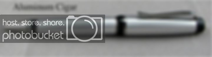

Used 6061 grade al. 3/4" round blank. Used normal woodworking tools. Roughing gouge to get close and finished with skew. Wet sanded to 2000 grit and final passes with a nonwoven pad to give the brushed aluminum look. Hides finger prints better.
Thinks to do
--Always cover the bed and motor and VS box are to prevent filings going in.
--Always wet sand using black automotive sandpaper
--wear eye protection and be careful of filings
-- when drilling do step drilling, start small and work your way up.
-- use a lubricant such as wd40
--glue tubes in with epoxy
--Have Fun

Wow John, really sharp looking cigar.:cool: You did a great job finishing the aluminum!:wink: Why the wet auto sanding vs mm? The one I made I used mm, is the wet automotive paper better?

Thanks Bob. Auto sandpaper is made for metal. Cuts easier and also the black from the aluminum will mess of the micromesh. Too expensive for that. If you were able to use the MM then great but I prefer the aoutmotive paper.

John, I want to start by saying nice looking pen. When you are drilling it out, why don't you just drill to the proper size and forget about using the tubes? I have done this several times and it has worked out great for me since the tubes are really unnecessary when you are using a solid material.

Yes that has been thought of. The reason I did not was the flexibility in the brass as opposed to the aluminum. In that I meant the brass will give more when installing the tranny and other parts. I may try it on others down the road. Alot of people do it that way also. I also want to try coloring the aluminum. I bought some candy apple powdercoating colors so that is in my future too.

And yes...I agree that cigar looks great John!
