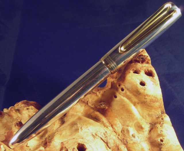

You mean kinda like this ?

EXACTLY Butch! That is what i am going to "attempt" in PR. Your version is AMAZING!

Here's the photo of the checkbook pen . I had to pry it from her hands . It is very slender to fit the loop and no clip , her checkbook has a zipper so it can't fall out .
It is made from some crushed velvet and stainless steel . There is a 7mm brass tube in the lower half and a 7mm transmission but no tube in the top
