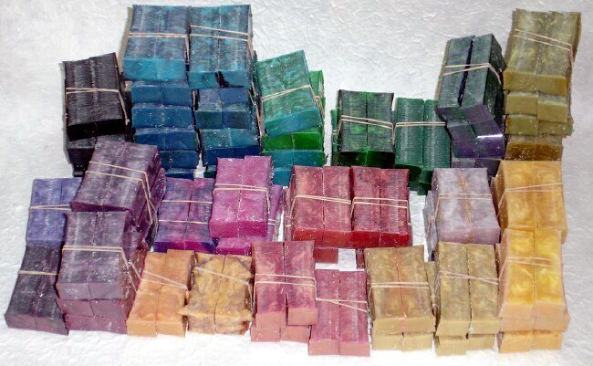

Here’s a boat-load of Polyester Resin blanks that got cast over the last two days. I’m finding that to get swirls and color variations in the final product, what works best for me is to thoroughly mix the hardener with and base compound first, then the powder pigment, and finally, the colorant...but don't mix the color in too much. Just swirl it around till it’s evenly distributed.

I'm using both the concentrated liquid dyes and the powders for color. From what I’ve seen so far, the powders work just as well as the liquids and can be a little cheaper in the long run. BTW, the "Duochrome" Luster Pigment powders offered by D&S are spectacular.

I have one suggestion, though. I also put a rubber band around the poly that I cast, but i found that no matter how long I let the poly sit if I wrapped it together (edge to edge) they would stick together. Now I wrap the band around one blank first, than around the other, so there is a bit of cushion between the pieces.
If I'm full of hot air, I apologize. This is what works for me[^]

Recently, I've been using the "MC-2" mold. Delvies is the only place I’ve found that carries this size...it's perfect to yield one pair of 3/4" x 3/4" x 2-1/2" after shrinkage blanks, with no waist. BTW, the MC-2 dimensions noted on this site are a little off...the molds actually measure 2-1/16" x 2-5/8" x 1-1/8" deep.
