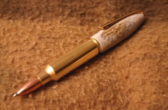

OK. I used a bullet for the nib instead of the one that came with the slimline kit. I drilled out the bottom or back of the bullet, and melted out the lead on the inside. The bullet polished up easily with Brasso after the meltdown. I know others drill the lead, but on a suggestion, I thought I'd get rid of the lead altogether. Now the question. The ink cartridge fits loosely in the hollow point hole in the bullet. Is this ok? The only other option I can think of using the no lead method is to fill the bullet with epoxy and drill again. I hate repeats.
This is a 300 win short mag. Antler is sanded to 600 and polished with HUT plastic polish. Finish is Shellwax. I like a little bark left on the antler. I say it adds character.

I think you have 3 options if the actual bullet is used. I assume you want to get rid of the lead because of health concerns. Here are the options as I see them. (1) leave the lead..the lead is actually inside of a copper jacket ...the lead will not be handled by the pen user.
(2) leave the lead..and do what I do and clear powder coat the bullet parts.
(3) remove the lead from the copper jacket and fill with resin or something similar and re drill. Sometimes doing a step twice is the price we pay to get things the way we want them. I have lots of the clead come out when drilling...I pull the lead plug out(not on purpose [:D] [:(]) with the drill bit. I hate when that happens...now I must drill another one.
Maybe some others will have some other options....Good luck.

Thanks for the input. Your casing tutorial is very helpful. I got it from another message board some time ago. I also plan to try one of the arrow pens you wrote about as well. Have you heard of Barnes bullets? Solid brass bullets. I think there is at least one other brand of the same thing, but I haven't gotten the name yet.

A guy here at work does re-loading. He said he has some "match grade" holow points that have an extremely small hole in the tip. Said they are very accurate, but don't expand properly on impact. I'll let you know how that goes. If the hole is as small as he says, you could drill out the back, burn out the lead, and then you have the perfect pilot hole to enlarge for the ink cartridge.

You don't need to drill out the back. Use the small opening in the point to start the correct size drill to make the refill fit. You might have to counter bore the rear for the refill to fit properly.

Well I drilled out the back end of the slug. Grab on to it with some long pliers. Take propane torch to the slug and about 15 seconds later the lead falls out. I wore a face shield and gloves, but the flame never got close to me. I let the molten lead fall onto some tin foil. That's about it. The first slug was pressed too firmly into the casing and deformed. I removed it by knocking it out with a rod through the drilled out primer end. Made the second tip and pressed it in. Seemed to hold fine in the casing. The casing I used was new, not fired. I bought casings from a re-loading supplier with no primers in the casing. This guy at work brought me some new slugs today. One is a match grade with a boat tail. I plan to apply a little glue to the boat tail before pressing in. The other is a ballistic tip coated in lubbolox. I think I spelled that right. Very dark gray color. Should look good with black titanium parts.

I wasn't sure how the plastic tip was attached to the bullet. I had originally planned to drill from the back side out through the end of the tip on the lathe. If it is simply glued into a hollow point slug then that might not work. I wasn't sure how the lubalox would hold up to heat, so I wasn't planning to melt the lead out of that one. On the bullets that I have removed the lead, I've been pertty easy on the heat. Very little buffing required to clean up the brass. The lead comes out about the consistency of stiff peanut butter. I keep it as close to the tin foil as possible when the lead starts to come out, so there's not a lot of splatter. Never hurts to be safe though!

The Barnes bullets hold in a collet very nicely. They are not hollow pointed, but a #2 center drill will start the hole nicely. The drill bit combination is a little different if you are using a parker vs a cross pen refill.
The smaller barnes bullets are brass (yellow colored). I have 0.224 and 0.308 in that color. The 0.338 are copper shaded (more red) in color.

Check out http://www.nosler.com/balltiphunt.html for a cross section picture of a Ballistic Tip hunting bullet and description of its construction. Oh, and there's a difference between the hunting version and the varmint version. I wouldn't recommend the varmint version for a pen because the jacket is much thinner at the hollow point. That may be desirable for rapid expansion, but not for writing.

I also use a torch to melt the lead out of the bullets that are going to be put in pens. I drill the hole for the ink cartridge one drill bit size smaller than the nib from the kit and use a small round file to inlarge hole if needed. I also epoxy the bullet into the brass cartridge and have had no problems. I've used the cigar and slimline kit on the 300 short mag. Your pen looks fine to me.
Your solution is much more elegant than mine, lol. I just sand the the point down until the meplat is large enough for me to punch a guide dimple so the drill bit won't skate.
