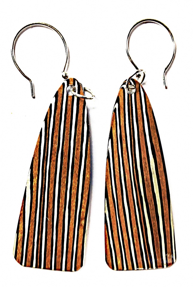

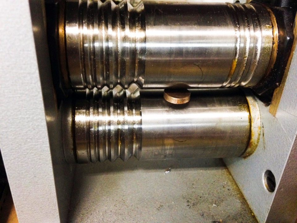

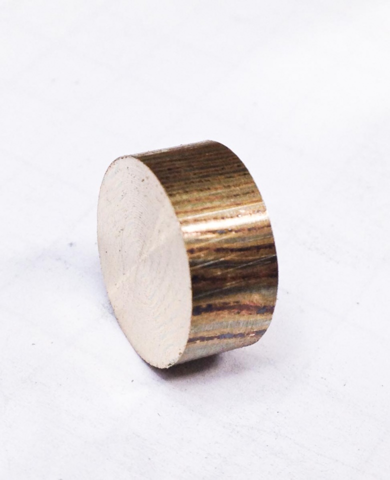

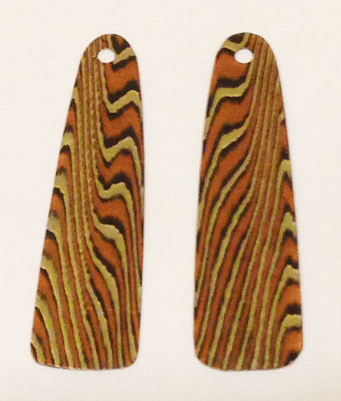

Made this pair of earrings from a small leftover 1/4" length of 14 mm diameter piece of Mokume Gane from my guild submission. Ran it through my rolling mill until oval. Shaped with grinder. Polished to 600 grit. Rubbed with Feldspar Patina Prep, rinsed with hot water and patinated.
Gave them to my wife...Thanks for looking. Doc:)

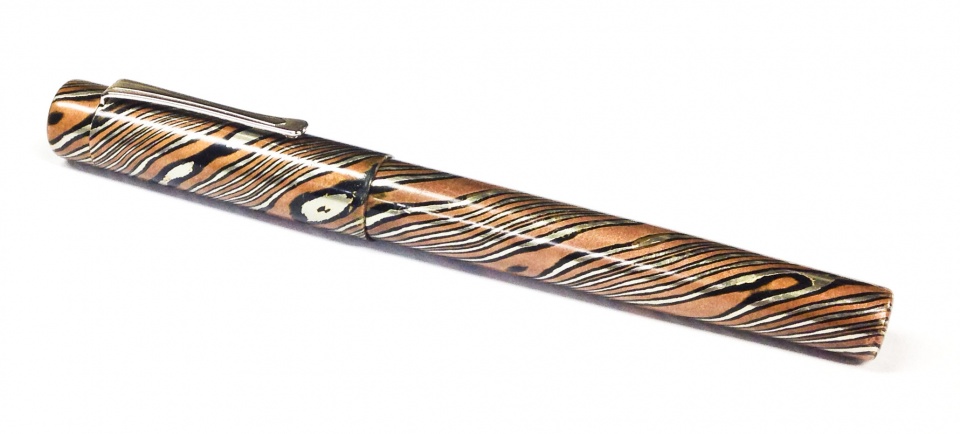

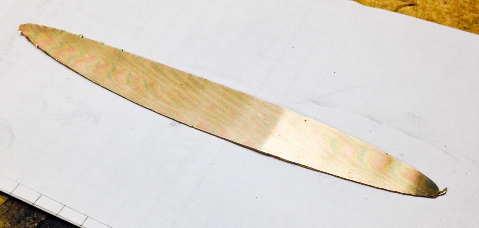

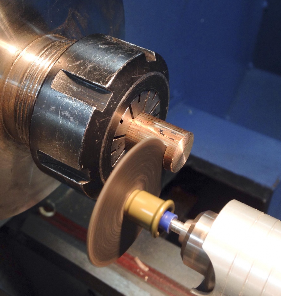

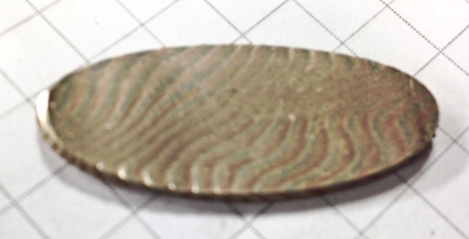

Someone asked me about how to make the earrings... so here are a few pictures when I was making another set. Doc:)

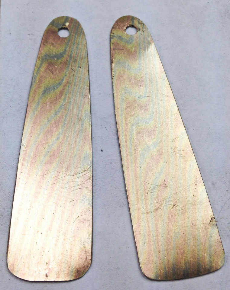

and finishing.. before and after patina.. only jump rings and loops left to attach..... Doc :)
