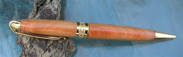

Would something like this fit the bill. The Olympia from AZ Silhouette. Here's a pic from my album. I shorten the upper barrel by about 1/4" and turn the lower barrel to match the CB.

I would classify the Olympia kit in the "Not a fast turning pen". It is extremely critical that the turning to bushing is dead on or you will have issue with the band in the middle. This particular kit also requires yo to turn to off to tube on the lower part of the top barrel.
Of course this is only my opinion.[;)]
