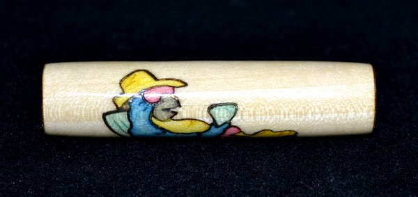

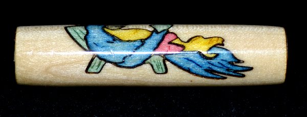

Inspired by Kallenshaan.com, I attempted to make a different parrot pen blank, this one holding a margarita. Close up there are obvious flaws, but I'm slowly learning how to design and cut my own inlay kits. I learned a key piece today from the Epilog Tech, frequency corresponds to width of cut! Not sure I'll make a pen from this one, but I'm on my way.

Almost forgot...I kind of cheated to get the different colors. I cut all the pieces out of a single blank. Then I used Alumilite dye in denatured alcohol to dye the pieces.
