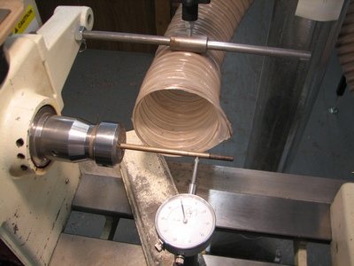

Here's what I use...

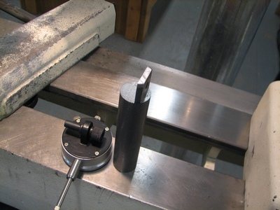

I made this one out of steel but I suppose you could use wood. Dial gauges are cheap, about $15 and some cheaper. Turn a piece to fit your banjo and put a hole in it!
Here it is disassembled...

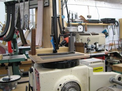

And here's where I keep it, always ready to check ANYTHING for runout...
The mandrel in the photo is the FIRST and ONLY one I've ever bought.
Put it in the lathe, bring the dials pointer up until it touches and then turn the lathe by hand. I turn it so the high spot is TOWARDS me and then give it a little tap with a plastic mallet AWAY from me. It takes about 30 seconds to get it within .001 at the right hand end of the mandrel. I can get it closer but that is quite acceptable for pens.:D
