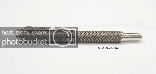

Fountain pen Black Titanium / Rhodium on Polymer Braid.

Les, you move the bar higher for us all. Unique. Original. Different. You make us all think about trying harder to find that surprise in our own work. Good job dude.

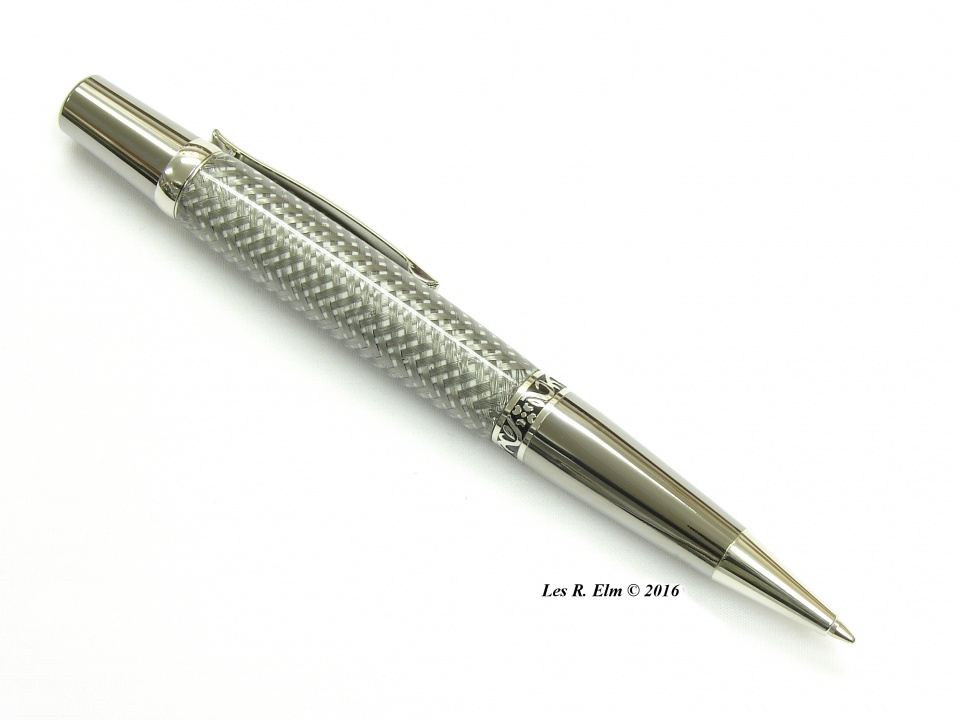

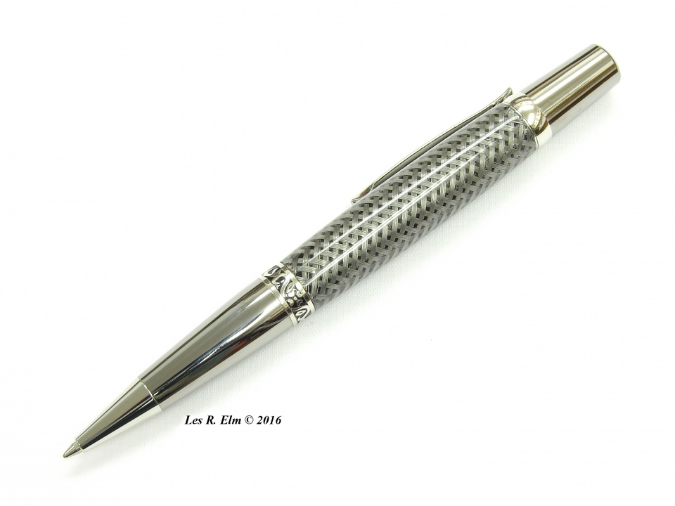

Thanks, Les! I'm going to have to try that. Question for you - aren't those plumbing lines usually stainless steel and, if so, would s/s work?
Rob,
These flexible water supply lines are made with both stainless steel and polymer braid.
I have done s/s cast in PR with black painted tubes and white painted tubes.
Tutorial attached.
Les
