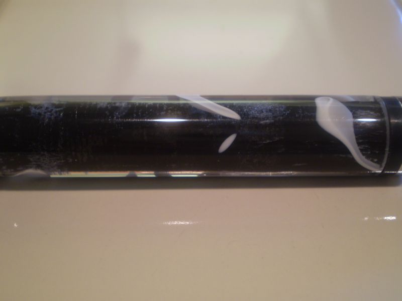

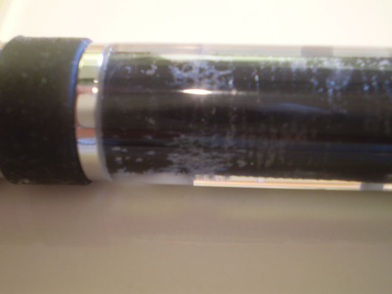

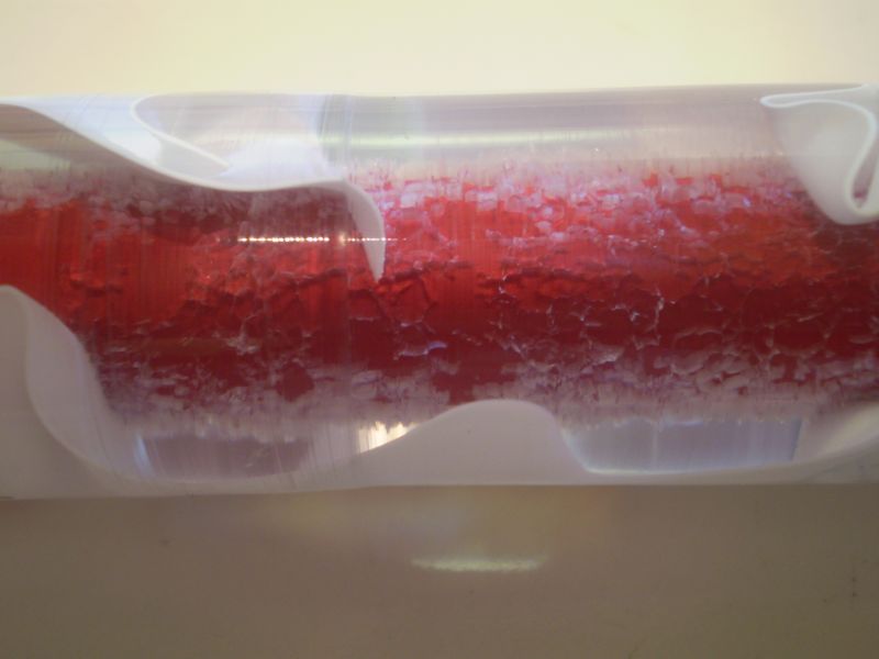

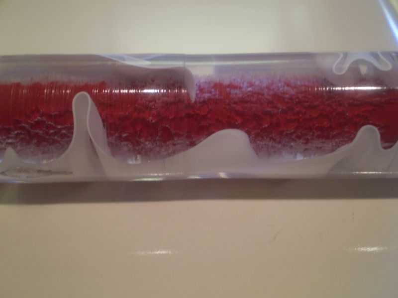

I recently bought some glacier lucite from exotic blanks. It is an amazing material that makes some truly stunning pens, I have just not been able to make such a pen...
The first time I tried it, I drilled on the lathe as usual: Dust collection, about 2500 rpm, a little wd-40. It doesn't build much heat and works well for me. I then sanded the inside of the blank and reverse painted it black with a high quality spray paint. Upon turning the blank, I noticed there were some small fuzzy, crack like objects that protrude from the outside of the hole into the blank itself. I didn't like that so I tried again...
This time I drilled at a speed of 10 minutes per inch. I turned the lathe down to 1100 rpm and only advanced the tailstock at the pace it wanted, no pressure at all. I drilled about a quarter inch, then backed out to clear chips, then back in. I made sure the bit was cool enough that I could hold it with no discomfort. The whole process took 30 minutes. I then proceeded to sanding for a long time, then reverse painting. I did two coats of clear to fill in any imperfections (so I thought). Then one coat of red. I roughed the blank and the cracks are back and worse than before.
This is a brand new drill bit, and there are no problems with the blank moving or anything. Does anyone know anything special about lucite or how to drill it?
All comments are greatly appreciated,

When we drill on the lathe we do it at the slowest setting which is 500rpm for us. It does not matter what the material is, Lucite, wood, Ebonite or PR. Generally we are through the blank (3" length) in about 5 minutes. You mentioned a new drill bit. New does not always equate to quality. The reason I say this is because of bits that are not straight. If your bit is off by say .002, then this will allow shavings that are coming through the bit flute to get between the bit and the blank wall, thus marring the side walls. (this is my theory anyway) New also does not always mean sharp either. We touch up our bits about every 15-20 blanks with the Drill Dr.
Consider it good or bad, when you drill something that is that translucent, you will see everything that is not working correctly. It would not matter if you are drilling Lucite, Plexiglass or clear PR. When you get it to work it is great and you can get some really neat results that you would not get with any other material. Because that particular blank is so clear we have avoided it until we can come up with an easy way to prevent something like what you have experienced.

It doesn't look like a problem with the material but, rather the paint. It looks as if the paint is pulling from the blank.
What are you using for an adhesive? There could be a reaction between the paint and adhesive. Try a paint that specifies plastics on it and let it dry overnight.
Also, there isn't a need to sand the inside of the blank before painting it. You can create a lot of heat very quickly when sanding. Lucite has a low melting point anyway.
Also when Lucite is exposed to certain solvents, it will craze. Ammonium-based solvents and cleaners can cause crazing.

The red blank is definetely heat cracking. You can see the depth of the cracking.
The green blank looks the same as well, but also has the look of paint not adhering in some spots.
Slow down on your speed, and continue with the peck drilling method.
The other issue with the green one can be caused by sanding too good.
The issue with transparent blanks, or very very translucent blanks is the ability to see all the problems on the machining of the id

and it could be ".....a little wd-40." and the paint. Both photos show signs of styrations around the inside of the blank - too finely together to be drilling marks if you are using a high quality drill bit but could be from a coarse abrasive.
An epoxy for glue???
Shine a light down the inside of the blank after drilling and see how many marks are on the inside. I suspect you are seeking to rough the inside seeking mechanical adhesion and making the mirror effect of the lucite show all the irregularities, and lack of adhesion of the paint adding to the issue.

As Ken said concerning the paint: . . . a little wd-40. WD 40 is notorious for preventing paint from sticking. It doesn't wipe off or clean out as easily as one might think.

Thanks for your thoughts, I will be more specific:
The black one was drilled normally at relatively high speeds and a fair amount of heat. Yes its paint didn't adhere too well, and I did use CA glue to put the tubes in. I corrected all of this on the other.
The red I drilled at 1100 rpm and drilled slow enough with enough lubricant that right after pulling the bit out I could hold it and it was no hotter than a piece of plastic that has sit in the sun. No heat, so the heat is not the problem (I don't think). That was a good idea though. As far as sanding, I wet sanded with a light touch, so that didn't build any heat either. I cleaned the inside of the blank out thoroughly before painting so there was no reaction between the paint and wd-40. The paint does not cause the problem because paint gets all over the sides of the blank when I paint it, and it doesn't cause any cracks. All that is left is glue, and I used 15 minute epoxy this time because of CA reactions.
Hope that is more clear as far as my procedure. What I don't understand is how when I was careful, the blank came out worse. The red is clearly worse than the black (no pun intended) even though I did what I thought was correct. Thanks again for the help, and hopefully the gears will keep spinning!

If you believe it isn't a paint issue, and it is actual crazing in the plastic, then I'm guessing it's a solvent reaction. Could be an ingredient in the paint you are using.

I agree with it not being paint because the cracks radiate into the blank starting at the outer edge of the hole. I will check solvents in paint and wd-40. Anything special I should look for?

Diagnosing ANY problem is a step-by-step process. In this case, we start with a blank that is very translucent. So, we can SEE if there are any problems before beginning---nope, no problem.
So, we drill. Once the drilling is finished, do we see these "cracks"? Having used an oil-based lubricant, we now need to eliminate that oil from the material and make certain it is dry to see any flaws. Do we see the flaws?
If not, allow to set for a day or two. Now it will be very dry--can you feel any oil residue? IF you can't see or feel it, you are still not CERTAIN it is not present, but you can continue. Paint the inside, as you normally would and do the same to a cut-off piece of the same Lucite (control piece). A day later do the two surfaces look the same? The control piece was never subjected to WD40--so if there is a difference, that is probably it.
Like all problems, this is a case of deductive reasoning--eliminate one possibility at a time, use a "control" piece for comparison.
Eventually, you find the exact cause of the problem, whatever the problem might be.
Good luck--you are young--could be years!!!:eek::eek::biggrin::biggrin::biggrin:

Every pen blank I have painted and used CA glue to hold it in has done exactly what you have! I found that when using paint I use epoxy and have no problem.
Ron
I am extremely suspect of the CA being the root of the problem too. If I had a piece of lucite, I'd put a drop of CA on it and see what happens. I know that if you put a drop of CA on plexiglass, you get exactly what you see here..a web of surface cracks. Experimentation is the key to success.

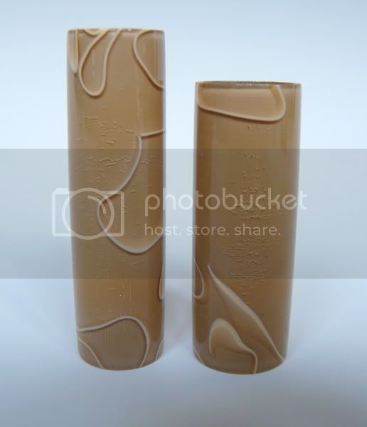

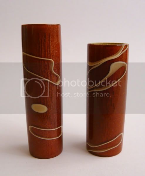

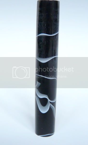

well i hope the OP dont mind but here's my take on this:
I Drilled both of these sets at 350 rpm then primed the brass tubes with white then painted them with the colour all done with rattle cans and left 4 hours before glueing in with 30 min epoxy- i also reverse painted the holes with the colour
I'm not sure whats going on with the el-grande tubes but the zen tube is diffrent there's only 1/3rd which has the problem which leads me to belive its heat associated as it would have been the last 3rd to be drilled and the bit would have been getting hot especially on such a long tube.
I have another blank to do today which i've sanded the inside of the holes to 4oo grit then painted-i'll report back on how that turned out!!

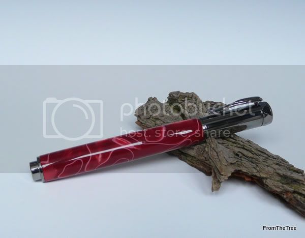

I did do this red lucite pen at the same time as the two above with no problems-

well i tried again and had similar problems!!!
I just dont think Lucite is worth the trouble- i'd like to know how to solve it.... but i think there are much better looking blanks without having these problems.
I did this euro a few weeks ago- the bottom half is a very see thru acrylic blank called citrine water- it has/had no issue's with paint or reactions etc
if it wasnt heat on that black blank of mine mapster- why has only 1/3rd of it got the issue? same paint same glue- why only have a reaction in one area?
