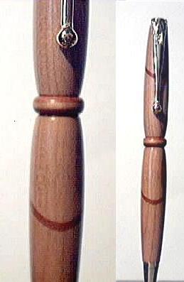

I buy tubes in 10" lengths, and cut the tube to the combined
lengths of the barrel and centerband. Then I glue both barrel
and centerband on the same tube. This results in a stronger pen,
especially if the centerband is wood and narrow. It is much
easier too.
This is a pen I made last year. It sold right away.
Image Insert:

If you look closely, the centerband is laminated too.
I use a bit longer tube to keep the proportions. And
make the centerband part of the lower tube simply
because that is what the users expect, that the band
will stay there. Otherwise they might be trying to
split the pen in the wrong place.
I hope this makes sense!
