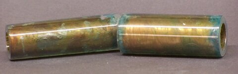

Mark, not sure if this is close enough, but if you want to try them, then you are welcome to them. They are made to fit the Jr series tubes.
They are clear cast tubes that look like they were in a sewer for a month:biggrin:
Expanding your horizons, Skippy???
Not only in the skip, now investigating the sewer???

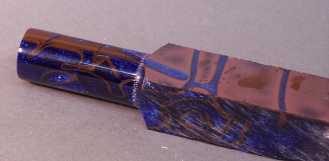

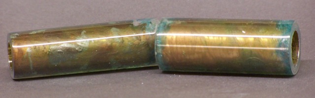

Mark, here's an acrylic that looked promising till I rounded the end:frown:
Good luck in your hunt:biggrin:

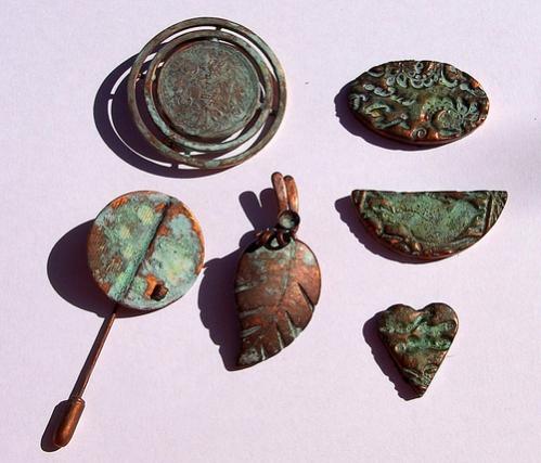

This effect can be achieved using polymer clay. I have been wanting to make a pen using copper verdigris for a while and just haven't had the time. I found some examples of polymer jewelry that was made using the verdigris technique. These are very traditional verdigris examples. In your case the blues can be customized to get the effect you need. The copper polymer clay has a great shine to it after it is finished.
Good luck!

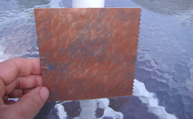

Hi Mark,

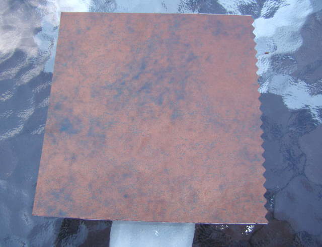

here is some "faux" foil paper that may be suitable for casting. If you think it will be suitable for you then I will mail it out to you 'accross the pond'.

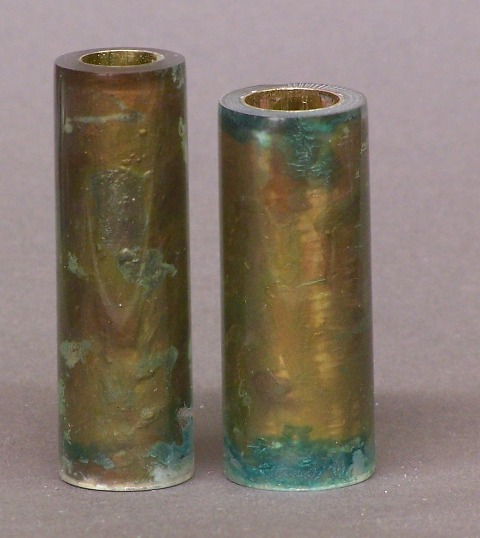

I would contact Roy <oklahoman> He makes pens where he chemically alters the look of the tube, then casts it. He even has a name for the finished product. Make him do all the work then you simply turn and polish!
