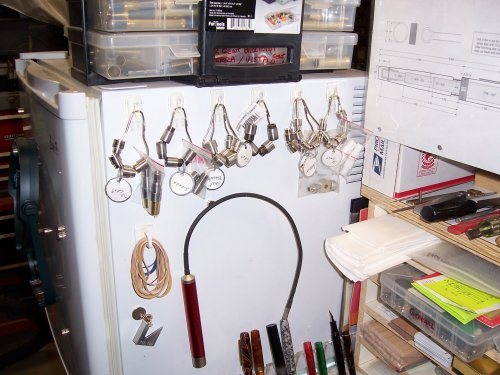

John, look closely at the photo below and see if you can find the penpal!:) I bought this last year and use it to mark every pen I make. It and my spring loaded center punch get a lot of use when making pens.
