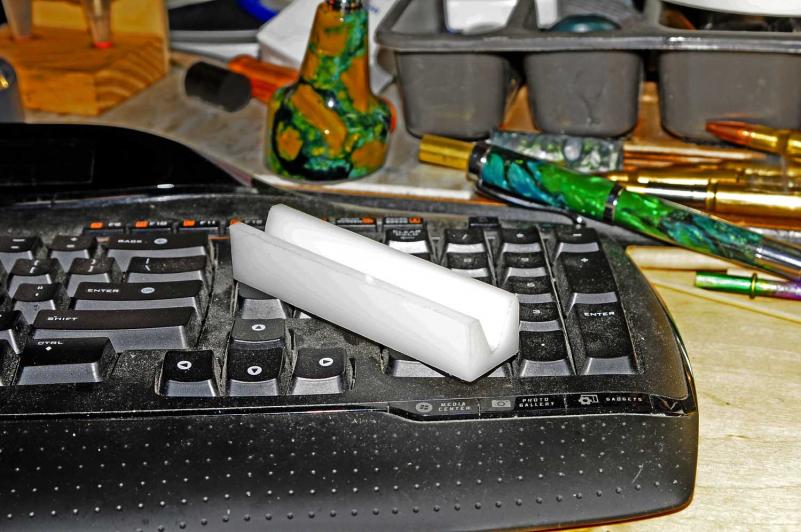

Mark: Attached is a picture of one I bought quite some time ago, and as far as I recall, it has never pressed the wrong length. I suppose we could get some wierdo length, or strange threads on a refill, just don't think I've ever had that issue. place a "hard"wood block under the ram of your arbor press, place this device, on the block, on end, under the press, place the tranny in the tube with the writing tip already installed, and place it in the v cutout of this jig and press straight. Bring the press down, so that it presses the tranny into the upper end of the tube until the press comes in contact with the jig. This commercial one is made from, I think, Delrin. but you could make it from hardwood, a acrylic blank, or whatever. It has served me well, it just has not caused me to really "like" doing slims !!!:biggrin: Edit P.S. Forgot to mention, it is 3.937" long or 3 and 15/16 of an inch.

Thanks for the information.
I realize I can't totally depend on a fixed size for all, but it should get me in the ball park the majority of the time.
I'm not a real big fan of slims either but I'm getting ready for a show and want to have some less expensive pens and stylus available. Additionally, I can use the jog for bullet pens which use the slimline transmission.
CSUSA sells that block: Press Block - Woodturners Catalog - Woodworking tools and supplies specializing in woodturning.
