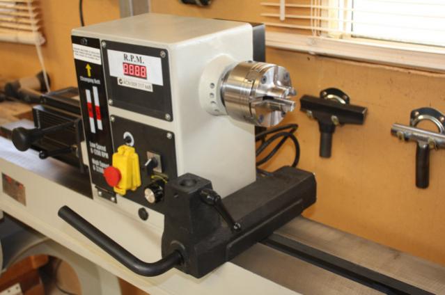

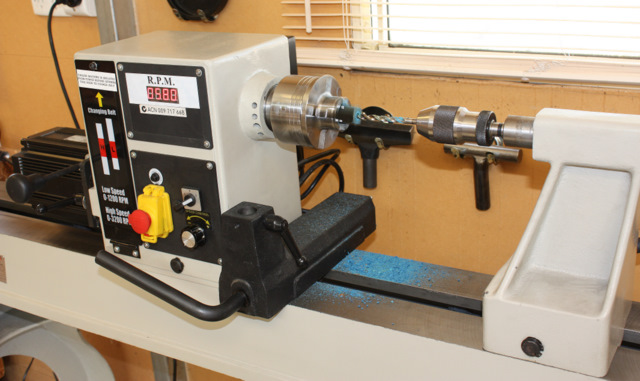

I have the Nova G3 chuck and do my drilling on the lathe. I use a set of Nova JSPIN pin jaws, they really grip the blank well, nice and straight and it doesn't matter whether you have a round or square blank.
