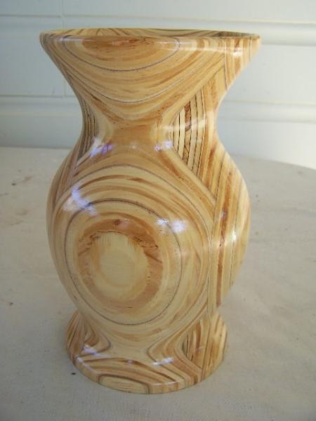

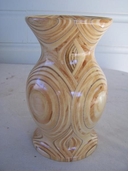

Finally got this one finished this afternoon. I started with a 10 in piece of ply 3 in square, and laminated 3 sheets of 1/2in ply all around to make a 6 x 6 x 10 blank.
The vase measures 9 1/4 in high and 5 3/4 at the middle, the top is 5 1/2 in and walls are 3/8in. I wasn't game to go much thinner.:)
Finish is 3 coats of WOP.
Thanks for looking and hope you enjoy. C&C welcome.

Outstanding workmanship in a beautiful vase!!
Thanks for showing the vase and means for assembly and finish!
I have liked the plywood turnings for several years, each one rekindles an idea, in me which I have never taken time to pursue.

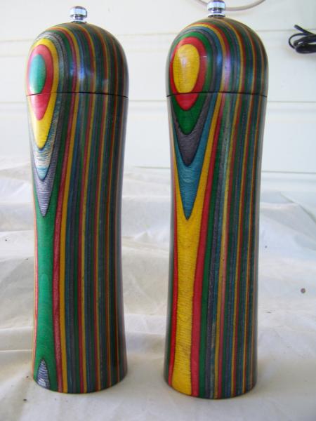

I believe you guys have something called Baltic Birch which is very good but not much color variation in the ply's. Of course this is important for the WOW factor.
You could always get some USA Spectraply and end up with something like this.:biggrin::biggrin:
Bob

Love the plywood vase... I just finished turning, haven't put a finish on them yet, two little 4" pepper mills from plywood. I think Lowe's is getting their ply out of South America now... it comes in metric sizes instead of the imperial measurements it used to... way back when I was still in the industry, my company used plywood by the train car load or truck load... our warehouse was around the corner and one block away from the Georgia Pacific company, one of the larger suppliers of plywood... it was cheaper for us to buy plywood in Brazil, pay shipping from there through the port in Florida and truck it to Houston, than to go around the corner and get it locally.... plus we got better ply with fewer voids....
Love the Spectraply also.... I use that a lot this past year, but they've raised their prices to a point where it's not economical for me to use it much anymore.... when they first started up they were looking for distributors in my area and I offered, but we never got it set up and then they got popular and didn't need me, so my price has risen some.
