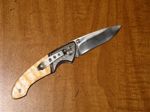

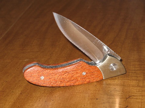

I made these two from kits obtained from Northcoast Knives. I used tools that I already own. (scroll saw, drill press, oscillating spindle sander,random orbit sander and hand files) The only tool I had to buy was a small torx driver and bit set to tighten the scales onto the kit bodies.

snyiper
Aug 24, 2009
1,601
St Inigoes, MD
Nice Knife kits Id like to get enough gumption to try one...I love those folders even though I'm a fixed blade guy
