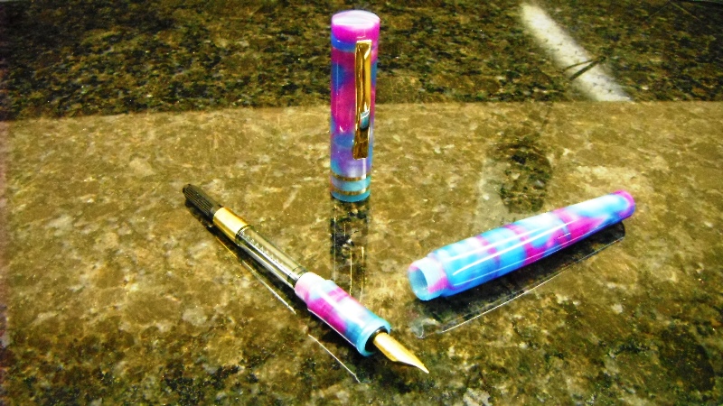

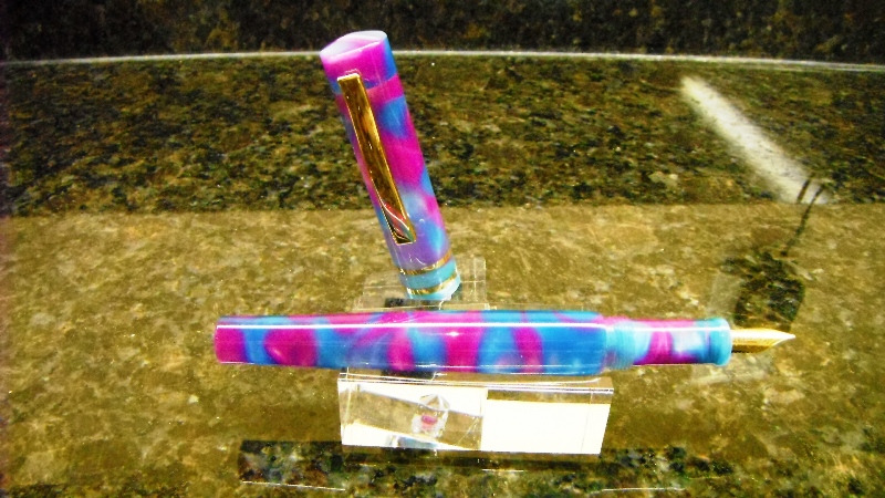

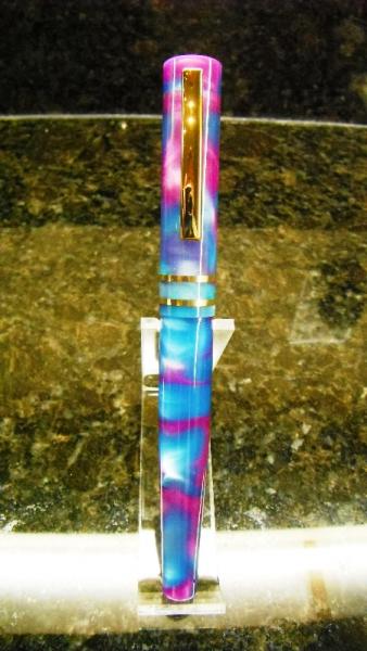

I made the body and section a while ago and put it aside. My daughter saw it, claimed it, and asked me to make a cap for it. So I decided that it was a good time to try a cap with bands. So I went off to the hardware store and bought some brass washers. I read over the tutorial by Charles Hutchings and off I went. The nib is a small tubular 6.1 mm Schmidt with a medium point. I am not a fan of the look of these nibs but I bought a bunch of them to practice with. However, they do write well. The blank is an acrylic acetate called purple rain.
Cap to barrel threads M12 X .8 triple start
Section to body M9 X .75
Weight 24 g
Weight filled 26 g
Length capped 6" (15.2 cm)
Length uncapped 5 1/4 "(13 cm)
Length posted 7 " (17.9 cm)
Barrel diameter at widest point 14.05 mm
Cap diameter 14.7 mm
Cap length 67.07 mm
Section at widest point 10.89 mm
All comments are welcome.
