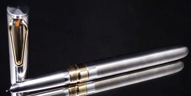

Aluminum is no problem to turn , even with just HSS tools but carbide means you won't have to sharpen them as often . Here's an example of both Aluminum and brass turned on my Jet 1014vsi . The threading was done with a Tap and Die . The clip is a brass rod .
