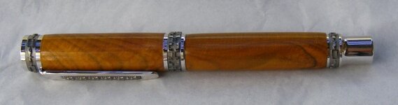

This is a Jr. Emp I made using my Jr. Gent bushings
