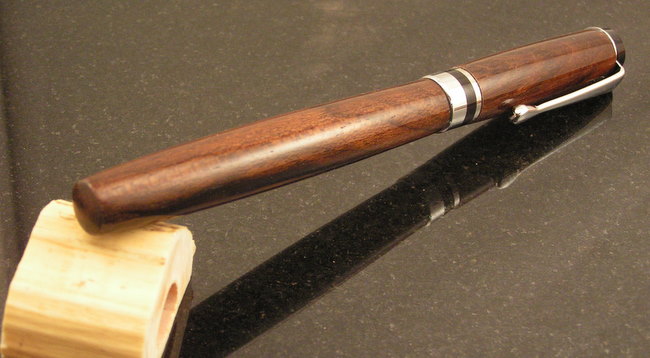

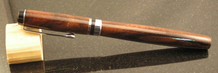

Here's one I did a while back, and liked enough to keep for myself. It's in the pen rack on my desk right now. I've done several more like this and they were well liked by their recipients. I don't sell them, I use them as loss leaders to entice known good customers to try fountain pens, and they usually lead to sales of higher end fp's. (so far, 4 of 6) which ain't bad, cause once you get somebody hooked on fp's it's like cocaine, they keep coming back :)
This is the slimmest fp kit I know of, and one of the lightest too. More like a factory fountain pen than most of the kits we use, from what I've been told. Only problem I really still have with them is the metal to metal threads, and the price. In good platings they are as much as a higher end kit. The Supplied FP section is all plastic, and I've had issues with them, but that don't apply here. I'm not sure if the RB section is plastic too, never ordered one.
