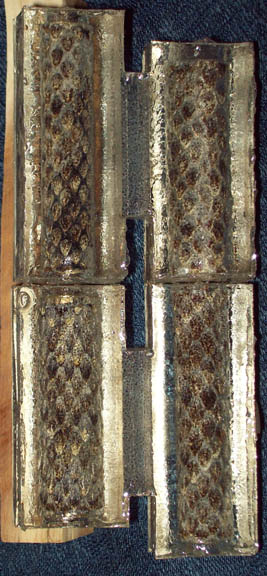

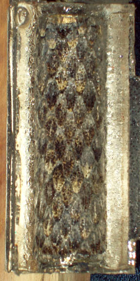

I have an order for two full size Statesman FPs in rattlesnake to fill.
Painted the tubes black
Waited overnight to glue on the descaled skins
Waited 48 hours for CA to outgass
Coated skins with medium CA
Waited another 48 hours for CA to outgass
Weighed out 4 ounces of PR, warmed in water bath to thin
Placed in vacuum at 20" for bubbles to rise
Removed PR and added 4 drops catalyst per ounce and poured over tubes in resin saver molds
Hardened at RT in about an hour, but some of the PR leaked into the tubes so I needed to add a little more PR
Weighed out 7 ounces of PR (was casting something else also), warmed in water bath to thin
Must not have mixed the catalyst well because after 4 hours it had not even started to gel very much.
Decided to place in 150* toaster oven for a few minutes and this was the result. Wasn't in the oven for more than 5-10 minutes.
Looks like the PR shrunk from the skin. :mad::mad::mad::mad:

I feel your pain. I was teaching my son to cast and the first thing he wanted to do was snakeskin. Out of 20 blanks he had 2 come out.

The PR did not shrink the skin but the oven sure may have. Toaster oven temp controls are not the most accurate. Calibrate it with a thermometer. 130 or so may be enough.
