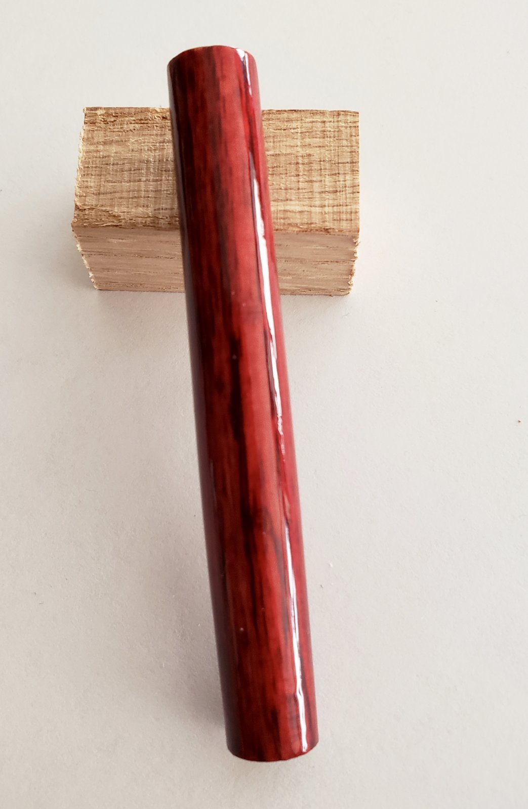

I've been working on a blank for several days and can't get it to turn out. It's oak that I dyed red. You can see raw blank I used as a prop. The GluBoost won't adhere to to the dye. I let the dye dry for over 24 hours, no wet sanding, used the accelerator (even more than two short bursts) and etc. It's been sanded to raw wood about 3 times now. Haven't had any issues with GluBoost prior to this but I've only used it on about 15 pens now. Any suggestions Thanks

So....when you say it won't adhere to the dye what do you mean? It just wipes off or stays tacky? What is the dye made of?

I have this problem with almost 40% of all pens I have done including regular CA, stickfast and most recently Glu Boost. I call it ghosting. I have had it show up during sanding, after buffing and on pens after a few weeks, a few months and I just had it show up on a pen after 2 years. Its the reason I decided to try glu boost and now that it happened with glu boost will probably switch back to lacquer.
I work outside on a wood deck and as such encounter a great variation in temp, wind, and humidity. I probably should have been keeping notes on these variables but I didn't. I did feel that high humidity was a problem BUT in honesty it shouldn't be - CA actually cures with humidity, in fact there is a guy on youtube that uses steam as his accelerator

George - I have done at least 30 dyed pens ---and many of them will NOT accept a CA finish. In many cases the CA seems to wipe off the dye. I have even allowed the dye to dry for months before finishing and still failed. Most of the time I finish dyed pens with lacquer. One of these days I am going to try sealing the dye with shellac and then putting CA over the shellac, but I haven't tried it yet
I just realized that I started this thread 3 years ago and don't even remember having the stated issue. I haven't had any issues with it since then. It may sound silly but I suggest you just don't use that (or type of) stain. The other thing you can do is call Glu-Boost. They are responsive to customer questions. Ask them what it is about the stain you're using that might cause that problem.

I was just piggy backing on George's statement about dyed blanks -- I have not tried dye with glu boost yet - but for traditional CA I can confirm for George (and anyone else trying dye) that I have had CA completely wipe off dye even after 6 months the dye drying. I am guessing it some kind of chemical reaction

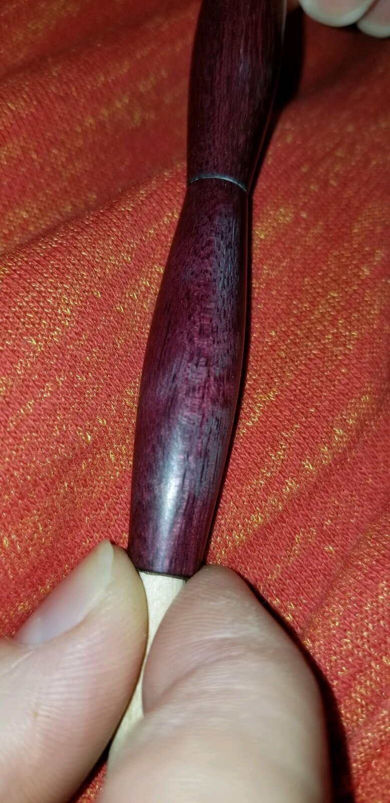

as for the original thread topic of hazing (ghosting or lifting) - this plagues me with traditional CA But I can now confirm that it happened to me with Glu Boost as well. I posted this image in another thread but just in case anyone searching in the future comes here -this is the spectacular lifting or hazing I got with Glu Boost on Purple heart - oddly enough top blank completed at the same time with same procedures is perfect
leehljp
Member Liaison
Feb 6, 2005
9,331
Tunica, Mississippi,
Ron,
THAT looks like sand-through. "Lifting" occurs on the ends when the bushings are broken off (it snaps) from the blank and the CA "lifts up" on the ends. "Lifting" or separation of the CA from the blank in the middle of the pen will only happen when the CA is thick, used on an oily blank and in all probability it is dropped.
What gives away sand-through other than the haze is the flat/matt color.
CA sand-through is usually lighter than the surrounding CA'ed blank, or haze as some people call it. The lighter color occurs with light colored woods, medium tan or beige, and darker and colored woods such as red and purple colored woods.
Do you use paper towel to apply the glue boost or CA? This is a common issue with paper towel (PT) applications. PT users often count the number of applications but the reality is that it doesn't mean much at all. I can apply 50 coats with PT and not get the thickness of two applications with a foam plastic applicator; and then I can apply with PT a few thick coats too. The point is: most people are totally unaware of how much thickness or how little thickness is built up on a pen per coat. Paper towel application can build up far less than new users would possibly believe. And then sand through occurs and it doesn't seem possible after 10 applications of CA/Glue Boost with PT, but it happens, repeatedly.
USE Calipers on a freshly turned or sanded blank; measure it. Then measure it after a few applications of CA to find out how much is being built up. Sanding takes a good bit off.
Another thing is that if it is on one side, that probably indicates the use of a mandrel, but not always. There are several problems that can occur with a mandrel that causes only one side to be sanded through. It "can" occur with TBC but it is much less likely to just occur on one side.
