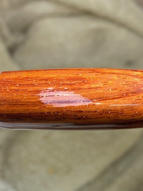

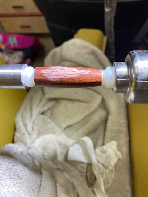

My latest (#5) was from a spotted cherry blank. I used GluBoost again but this time I wet sanded with MicroMesh. On my final pad my blank showed a whitish spot. Went down a grit and it got worse. I'm assuming I went through the GluBoost???
I re-applied several coats of the thin GluBoost and after MicroMesh and buffing all was well. My best looking pen yet!
