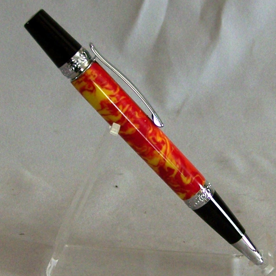

OK - I did it - I turned the blank down to round and then I got some 40 grit aluminum oxide sandpaper, followed by 80 grit, followed by 150 grit, then 240, 320, 400, 600 then all 9 wet micromesh. It is a beautiful pen.
Smitty37
Passed Away Mar 29, 2018
In Memoriam
Nov 23, 2009
12,823
Milford, Delaware 19963
It has a tiny chip under the clip that happened when I dropped the blank after it was finished....not big enough to make me want to fix it (since I'm keeping the pen for my own use) but it has convinced me that I wouldn't sell a pen with these blanks too brittle to suit me.
