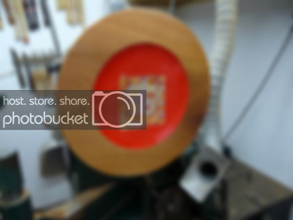

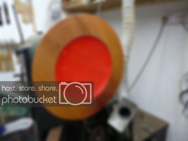

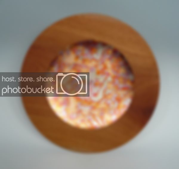

this platter is mahogany with an imitation schlag metal variegated red leaf centre
18" diameter by about 1.5" thick

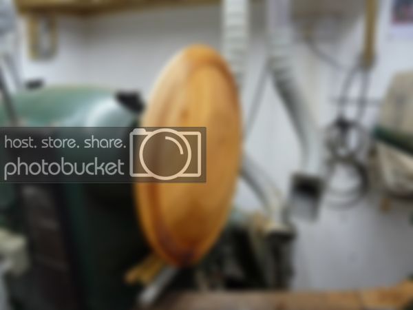

back of the platter
nearly finished in the workshop

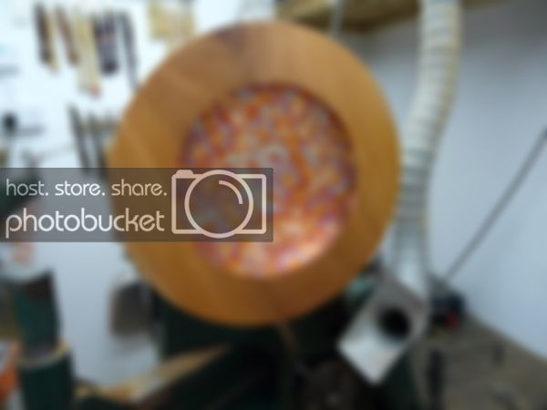

finished piece

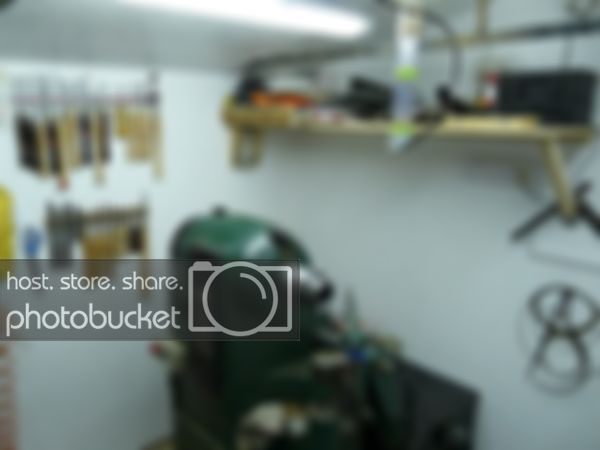

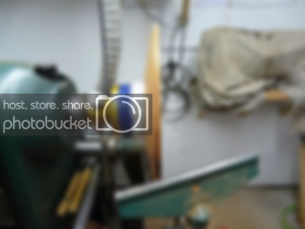

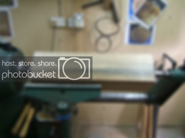

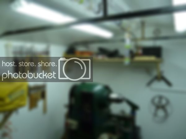

yes my lathe is a vb36- i've owned it from new for about 10 years-brillant lathe
here's a couple of shots of it when i recently boarded ot the workshop and painted it

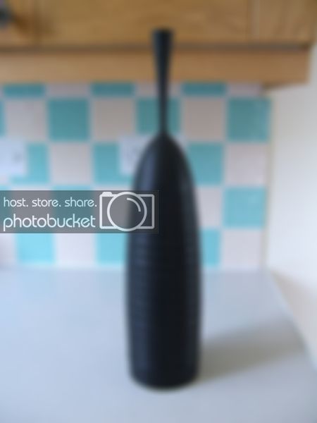

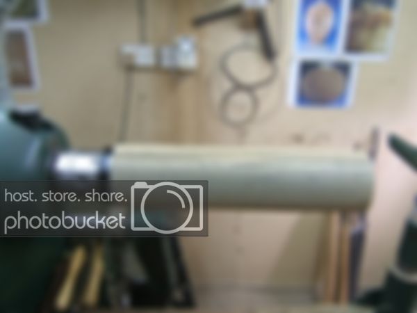

here's a benoit averly inspred piece and a couple of pictures of it in progress
all of this overhang but because of the superb bearings the lathe doesnt even flinch, no noise no vibration no problems- i've had some huge pieces on the lathe and it just takes it all in its stride:)

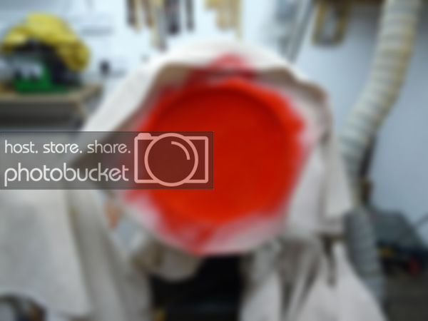

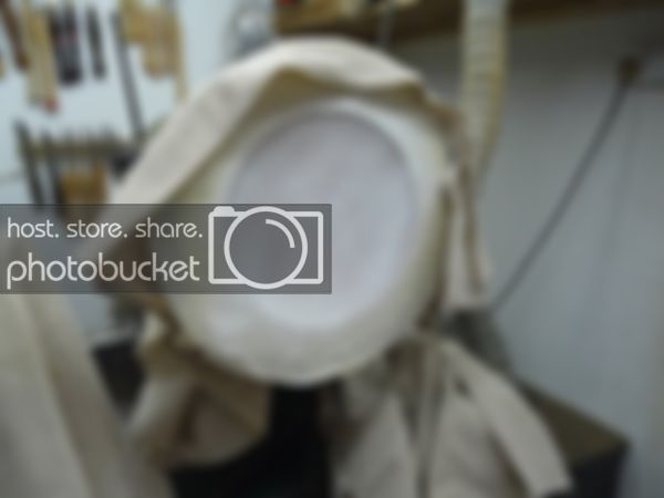

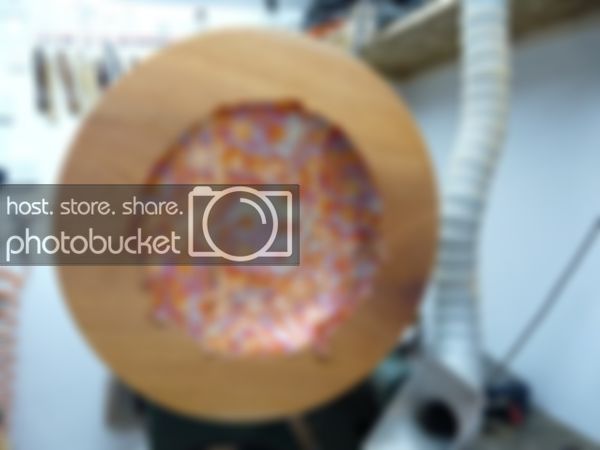

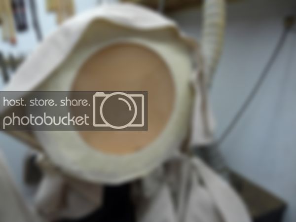

Louisbry:its not difficult to apply- but you do have to have some way of being able to seperate the leaf area from the wood area- a way of making a stop start point, on this piece i used a tiny v cut between the rim and the leaf- this helped me when i had to mask of the rim to apply the paint and it helped when i had to apply the leaf

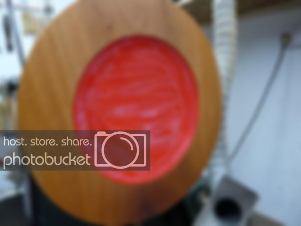

here's a step by step of the leaf process
masked out ready for paint
white shellac primer applied which seals the surface ready for leaf
red base colour- deepens the effect of the gold
un masked
I de-nibed the red and put a gold leaf size on
when the size went tacky (about 5mins)the leaf started to go on
after all of the leaves
all of the loose bits gently brushed of

Hi Toni
seal the timber prior to leaf? or seal the leaf after application?
to seal the timber i use zinnser BIN which is a shellac based primer/stain block
to seal the leaf i use laquer or varnish
