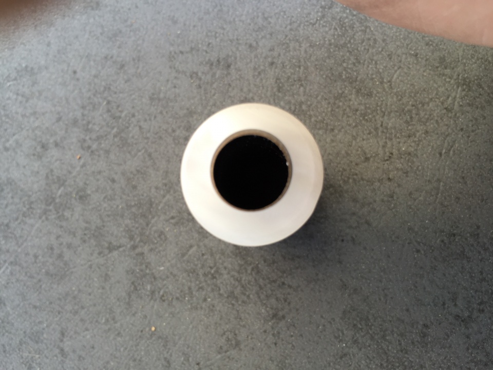

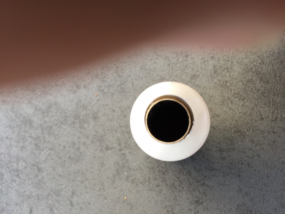

The issue is that when I was drilling some acrylic on my lathe, I heard more noise than I was used to. I thought it might be that the acrylic was a bit harder than it had been in the past.
Well, the outcome wasn't pretty. As you can see in the photos, the entry hole is fairly good. The exit hole is much larger than it should be.
I think I may have neglected to tighten the tailstock quill lock handle. Does this sound like a reasonable reason for the result I am seeing? Any other suggestions? The bad thing is that I drilled a number of blanks, painted the inside, waited a few days and then epoxied the tubes in. As a result, I have three pens and two perfume holders that are a bit messed up.
I will let you know how this turns out, but in the meantime, could I be on the right track?
Thanks,
Warren (the perplexed and unhappy)

Warren, if you had any vibration when drilling the unsecured tailstock quill could easily be the issue. I've done that and immediately stopped and checked the setup and found that to be the problem.
I'm wondering about the pictures you posted. Is one of them the entry hole? If so, it seems that both ends have issues. Maybe your drilled hole is supposed to be that much bigger. I know many will tell you the hole has to leave room for the glue. I try to keep mine real close to the tube size. I figure that when I glue and clamp 2 pieces of wood together making a cabinet, there is very little room between there for the glue and it holds just fine.
When drilling on the lathe and the drill bit is not perfectly in line with the blank or it is moving off center while drilling, it will never turn out well.
Imagine that the back of the stock is moving in a larger circle than the front and it is moving in such a way that it is wobbling. It is doing this in reference to the drill bit that is not aligned with the stock. Under that situation there is no way you will get the holes the same on both ends.
I center drill and turn all my blanks round before drilling and they are turned to the same diameter all the way along the length. When I put the blank in the scroll chuck, I make sure it is turning true to center using a dial indicator.
Typically the blank is cut somewhere in the middle and the end where the drill bit is going needs to be smoothed and I make a small dimple in the center with a round scraper. That lets the drill bit end get a perfectly centered start. I advance the bit with the tailstock quill very tight so there is no chance the bit will walk. Only when the bit has gone past the outer flutes do I ease up on the quill.
When doing this I must hear and feel absolutely no vibration the entire drilling time. I use short advances and retract the bit, vac off the shavings and cool the bit and blank with the vac. On some acrylics I use veg spray lube. I only use standard jobber bits but not the really cheap ones.
Typically I get a .002" variance from front to back because that is how much runout is in my lathe headstock. And from what I have observed that is better then many new lathes out there.

If you don't mind, could you walk me through your drilling process?
Locking the quill would insinuate that you are pushing the tail stock by hand to advance the bit through the material. That will allow the bit to wobble making for a sloppy hole.
What I consider to be a reliable practice is to lock the tail stock, and advance the quill using the handwheel into the blank: slow, and about 1/4 - 1/2" between completely withdrawing the bit to clear the swarf.

I just went out to the lathe, and of course Clark was right on target. I of course did not lock the quill so that I could advance the drill using the tailstock handwheel.
I still think the tailstock/chuck was the issue, and most likely the tapered drill chuck was not sufficiently tight within the morse taper. I just tried another blank (wood this time) and was careful to assure that the drill chuck was tightly held in the morse taper. When i was through, both the entry and exit holes were exactly the same and were the right size. I guess I just got careless; you know familiarity breeds complacency.
Thanks for all who looked at this and didn't shout out WHAT AN IDIOT! THAT CAN'T BE THE PROBLEM. STAY AWAY FROM SPINNING MACHINERY!
Oh, well, back to the garage.... I mean shop.
Thanks again!
Warren

As I indicated, I think you are right on. The improperly secured tailstock (or rather the tapered drill chuck) was most probably the issue. I jumped right to the material I was drilling rather than stop and listen to the little voice in my head. In answer to your questions, the entry hole was much better than the exit hole. In fact, I went ahead and finished one and it worked out all right, but the second was a disaster. I drilled the hole with the size drill bit recommended for the project. I suspect the oversized hole was a result of the slop in the chuck/taper.
