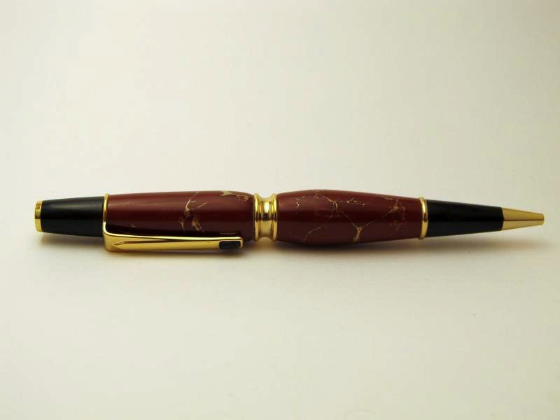

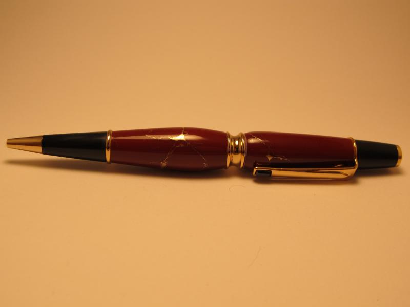

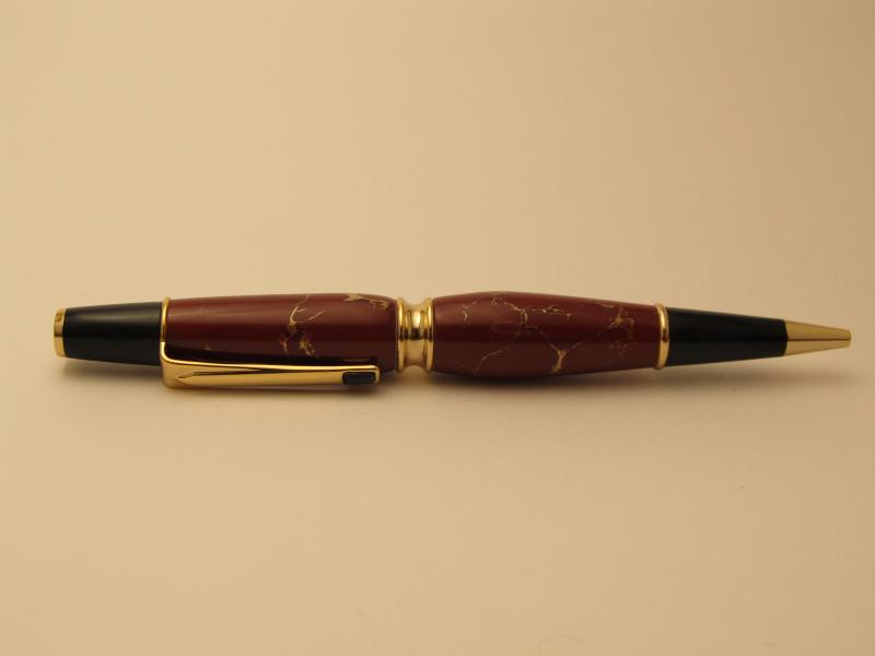

I took a few pictures on various settings, and moving my light source around, but I'm not 100% satisfied with any of the pics I've gotten so far.
Here's a few I took...some on manual, some on auto/easy. What can I adjust to get a better image?

Might help if we could get a bit more info. What type/brand/model camera is it? DSLR or Point& Shoot? You mentioned manual and auto modes, what sort of control does it have over exposure (shutter speed & Aperture or just +/- exposure compensation)? What are the options for color balance, and what type of lights are you using?
Looking at the photos, the second 2 are certainly better than the first two, and I assume they are the ones you shot on manual. You still need to increase your exposure (+ compensation, or longer shutter or wider aperture) to lighten them up, and your color balance is off in the red/magenta direction, but it's hard to nail that down till you get the exposure closer. Not sure how many lights you're using, but your shot is a bit back lit. I'd suggest either bringing them forward a bit or adding another or 2 above and in front of the pen.
Composition wise, your pen is composed a bit "flat". Composition is a lot of personal taste, but generally strait, square to the camera is not the best viewpoint. I'd suggest angling the pen tip toward the camera a good bit to give some depth to the image.
Then pen looks FANTASTIC!!! I really want to try that pen style, but haven't gotten around to ordering any of them.

#1 is to get the color balance right and then to mess with exposure. I did a 15 second tweak on one of them to show you what I mean, but its best to do this in camera if you can.
What camera did you end up with?

OK, so it's an advanced Point & Shoot, your ISO ideally should be set as low as possible to enable you to shoot, but in practice, most newer cameras are fine in the 400 and lower range. Assuming you have a tripod (you mentioned it in the package) and the camera has a timer release (so you can push the button and the camera will wait 2 to 10 seconds before taking the photo so the camera will stop vibrating) I would suggest you keep the ISO at or lower than 200. Not sure what type of lights you are using, but the camera has settings for the top ones (daylight, tungsten, 2 different flourescents) if your lights fall into one of those categories, try setting it to that ans see if you have better color balance. If none of them work out, read the manual about how to set a custom color balance (there are a lot of different methods to do this, so you really need your manual...) Then work on the exposure, and if your lighting stays relatively consistent, I would suggest going in full manual mode, and keeping with the tripod mode, set the aperture in the mid-high range (specs I found did not list the lowest aperture, just the highest of 3.4-5.6 depending on the zoom position) which is probably going to be a number such as 11, 16, 22, etc. Stick with 11 or higher, and if you have trouble keeping the pen in focus front to back, move higher still. Then figure your shutter speed based on that aperture. The camera is likely going to suggest a shutter speed, but that will likely give you too dark in image. Play with the shutter speed and get a feel for how far open from the meter reading you need to do to get the photo looking right. It will probably be telling you that the exposure is 1.5 to 2 stops overexposes, but this is fne.
And I'd still say to either move one or 2 of your lights more forward or add one or 2 ahead of the pen.
