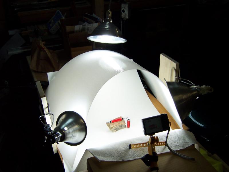

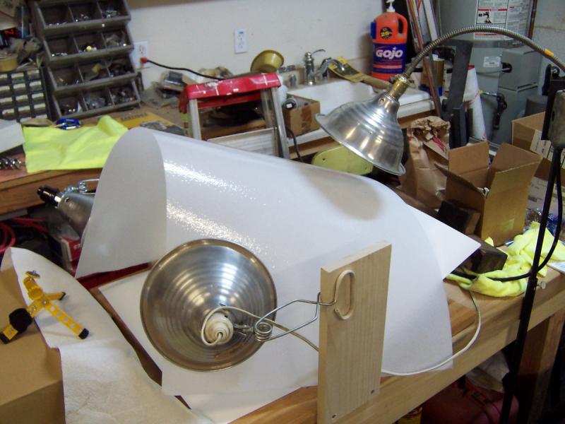

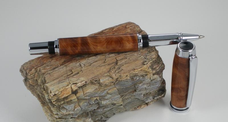

I'll be the first to say it, I'm cheap.

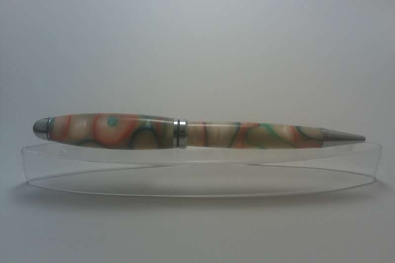

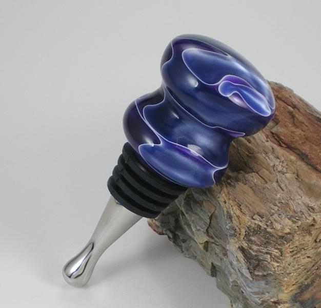

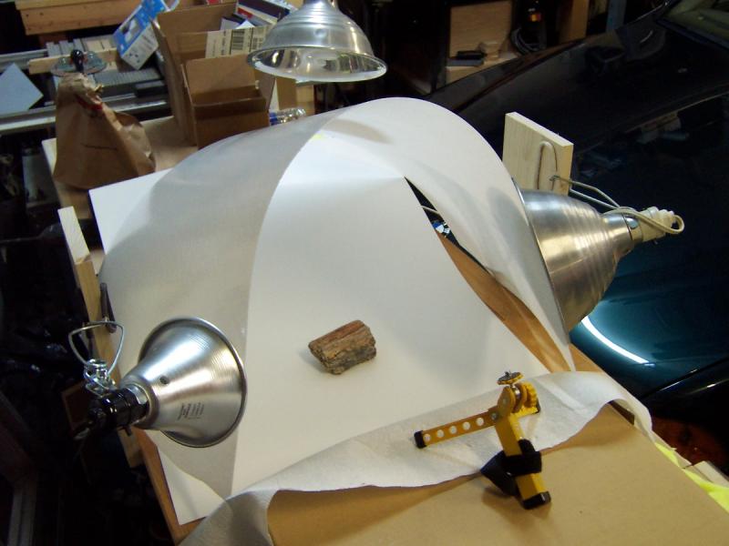

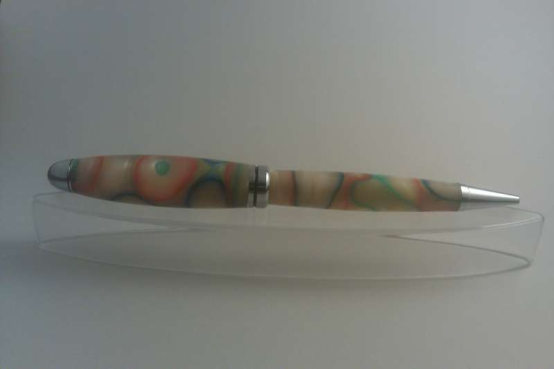

Here are a couple of shots of the light "tent" I came up with. I used a left over piece of butcher block from my work bench, a couple of pieces of scrap for the lamp holders, and an overhead flourescent light defuser panel. The panel was about $9, I already had the clamp on lamps, and I purchased a box of very white (6200k) flourescent "twisty" bulbs. The panel stores flat and I can unscrew the "uprights" to make the whole thing flat.
I'm just getting started and am working with a pretty basic camera (ordered a new one last night) but the shots are pretty good.

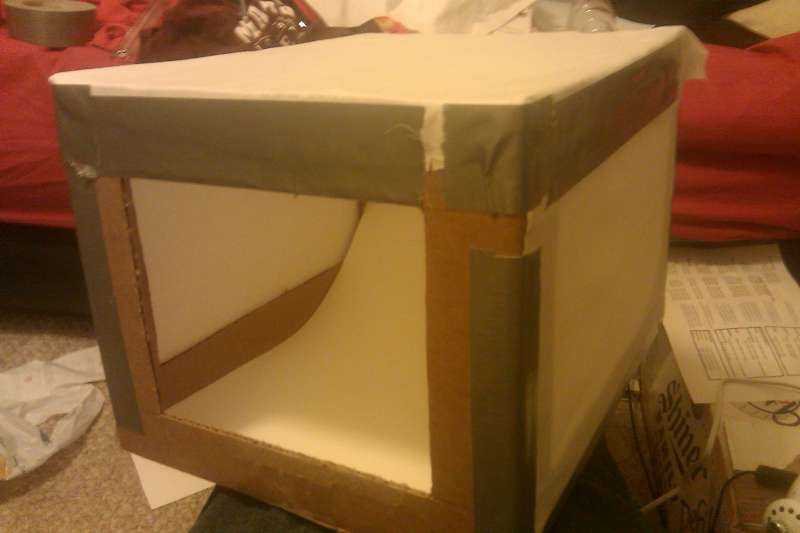

So I made it...cost me $3 plus a cardboard box I had lying around. A yard of fabric from hobby lobby was $2 and a large sheet of white drawing paper was $1. I used duct tape to put the fabric on the box (I tried superglue, but it was wicking the glue and not holding). I'll take a picture of the box, and with the box, momentarily (Now I need a bigger light tent to take a picture of the light tent I just made :D )
Scooley01
Nov 28, 2010
204
College Station, Texas
Not sure how to attach files when you're editing a message...here they are. I have a 75 watt "Reveal" compact fluorescent bulb in a desk lamp over the top of the box in one pic, and on the side of the box in the other pic. The pics seem a little dark...but those are on my cell camera so maybe a better camera would make a difference. I used my cell camera so I could compare directly to the other pen photos I've taken.

Chris, you have a cool set up, but, my favorite item is that table pod. That is about the coolest table pod I have ever seen. Good thinking on you set up. It should work for quiet a while for you. the only improvement on your set up I see cheep is possibly a camera shield. That is simply a white piece of card stock with a hole cut in it for the camera to see through. This will eliminate any possibility of catching a reflection of you or the camera in a shiney surface. It does happen.
Charles
Aug 13, 2010
150
Cameron Park, CA
The tripod is a camping/backpacking unit I have had for years:
http://www.rei.com/product/777249
Thanks Charles, I did need to put some white paper (paper towell because I was too lazy to raid the kids art supplies...again) to block the color of the box my tripod is sitting on. I also ended up with the pens set further back in the tent so the ceiling lights (yellower) didn't show. I will add a camera sheild next.
Chris

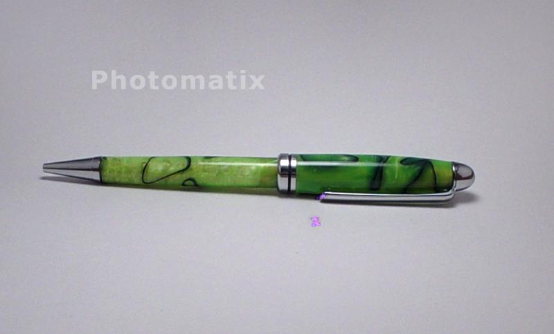

Here's another photo taken with SDP777's PhotoMatix method (elsewhere in this forum). Ignore the weird purple blobs my camera puts in the dead center of every photo.
