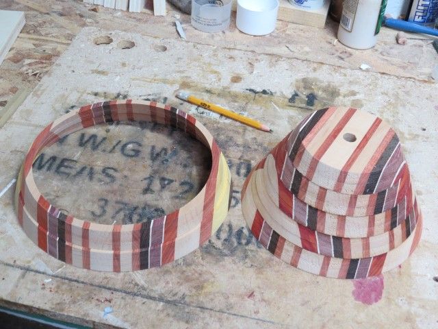

I glued up a nice board with a bunch of exotic plus local woods this morning . Checked the thickness with my digital calipers in order to set the right angle for the rings to be cut at . Caliper was acting up a little with numbers dancing around and I didn't really know why so proceed as usual and set my angle a few thousands of an inch wrong from not getting a consistent caliper reading . Didn't realize it until I set the second ring on top of the first one and found it was WAY out . So off to the dollar store to get a new battery for my digital caliper and re-measured and re-set my angle for what was left of the board .

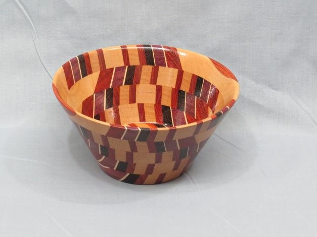

So two rings that were going to be the top of a 9" bowl went into the designer firewood box and what was left over will make a 7 1/4" bowl when I get it sanded down and finished .

I would take those two 'mistakes' in a heart beat.
Not only a ring for a wall clock but a frame for a mirror that I would engrave.
I don't see any problem either.
OH yeah , I like the mirror idea even better . I shy away from clocks after having made so many of them in another life.
I might get an estimate from a local glass man to see how much it would cost for then to make a mirror that size to fit .

Bill; I could see your original design right away !! A nice bowl for the table with a matching framed mirror hanging over it. There are few mistakes in woodworking, just a representation of the original plan. :rolleyes: Great looking glueup. Jim S

Well , what was left of the mistake turned into a fairly decent bowl and I have saved those two top rings for future use after I decide on what to turn them into from so many suggestions here and elsewhere.

I thought it looked like plenty of wood to turn down those two rings. I've done bowls with less than 1/8" walls.
So have I from a one piece block of wood . But your 1/8" wall probably didn't have a glue joint. Whenever a ring is out that much on the outside , it is out the same amount on the inside leaving very little in the middle when levelling it out from both sides . . Yes , it would have survived a 1/8" wall but I would not feel right about a glue joint that thin on a large bowl .
