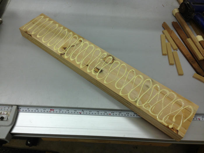

Day one:
LVL leg glue up
A pile of legs ready to go
Base frame glued, nailed, and squared up
Legs installed and another set of LVL's inside. I know I do not need them for strength since LVLs are plenty strong but I wanted them to lock in the legs and provide extra weight. The clamp goes to some waste block I screws on to the outside to precisely true it up square. By tightening or loosening the clamp just a little, I can change the squareness.
Results at the end of day 1

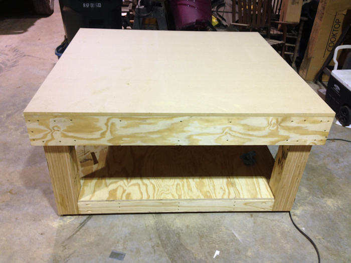

I am sure you guys are getting bored with base pics but I am going to give them to you anyway! I installed the "joists", the MDF top, and the plywood skin to the top section. I believe I am going to wait on the lower skin until after I decide how I am going to use the space underneath. That will be easier once I have my machine and know what I am dealing with as far as electronics, etc. I plan to put the controller and other electronics underneath and may even put the computer box there. Not having any idea what the heck I am doing without parts, I think it will be prudent to wait and see how big of doors or drawers I need to build. I plan to paint the top and skin tomorrow and get ready to start the machine build, hopefully this weekend!
Anyway, here are the progress pics from Thursday night.
Here it is after I installed the joists. I used pocket screws on each end with glue. These are also LVLs. They look funny because I planed them down to get them nice and even and straight. In some cases, I planed through the outer veneer and the black areas are the glue layers.
Here it is with the MDF installed. I ran a generous bead of Titebond2 along each framing member and the nailed it ever 6" or so with 2" finish nails. I was going to use screws but decided nailing would be easier. Besides, I just had to keep it in place until the glue dried since glue is stronger than the wood itself anyway! It is perfectly square verified by measuring the diagonals.
And here are a couple of shots after I put the skin on the top band. I used 1/2" plywood and plenty of Titebond 2. I ripped the ply about 1/6" oversize and flushed it to the bottom. I nailed it all on with 1 3/8" 23 gauge pin nails. Again, all it has to do is hold it there until the glue dries. After it was nailed up, I used a flush trim bit in my trim router to trim the top of the ply perfectly flush with the MDF.

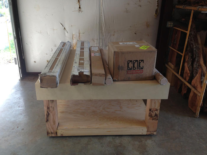

Friday afternoon I had a couple of college kids helping me clean out a spot in the shop for the machine and get ready for the assembly. The spot where I am putting it is where I was storing a few thousand pounds of different burls and logs I have harvested so all of that had to get moved and re-stacked! Then of course everything had to be swept and vacuumed. That was quite a undertaking itself but thankfully, I had 2 strong guys and did not have to lift a finger!
The base was moved into place and leveled up and ready to go. The UPS truck showed up at his normal time of 5:20 or so and we unloaded the parts. Man, were some of them heavy! Here is $4,000 worth of parts ready to unpack and start assembly! Kinda shocking, actually, that these few boxes cost $4k and will be used to make a precision robot!
Last night I worked on unpacking the parts and getting them spread out, ready to build. Today I will be spending the day putting stuff together!

Very impressive and sturdy looking base. I reckon at the speed you are progressing, you'll be in full CNC production by this time tomorrow!!! :eek:
I would have thought that it might be a bit taller so you could get a more user friendly storage area underneath. What made you chose that table height?

Skiprat, I thought about going taller but I looked at the spoilboard height of a number of different commercial CNC routers and made it so mine will finish at the same height. I work mostly with 4'x4' acrylic sheets and a 4x4 piece of 1/2 acrylic weighs a LOT! The top of my spoilboard will be proximately 34" off the floor when complete and I figured that is high enough to have to wrangle a piece of heavy material onto by myself!

Ah !! 34 inches is good. It guess it just doesn't look as tall as that because it's such a big and chunky size.
The table itself is currently 29.25" to the top. The aluminum extrusions for the cross members are 4" tall which brings it to 33.25". Then I will add a 3/4" MDF spoilboard to that to bring the finished spoilboard height to 34". The top band of my base is 7.25" which makes it look short!
