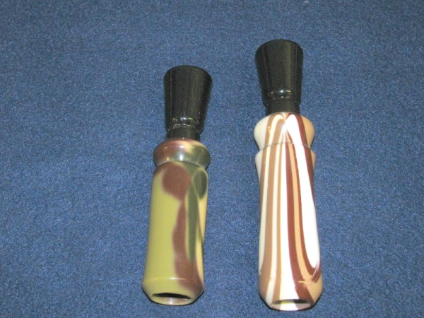

The instructions on the duck call mechanisms say you need a three inch long blank. The imported camos are 1.75 x 2.875 inches, so I can cut them to 1.75 square by just under 3". So the camo "quacker" shown below is under three inches long. But it quacks like a duck (call), so is it a duckcall???
So "Ducky guys", can this material "suit the bill" so to speak??
Thanks for your feedback, both serious and otherwise!!:biggrin::biggrin:

Ed, You're Quacking UP! :) Sorry.. I don't have a clue.
I would be curious though - from my waveguide theory class, the sound should be either a different frequency OR volume based on the length. That doesn't however mean that longer is better, the 1/8" or so shorter could actually make it louder. I doubt that the frequency is affected much because these are reed based.
But then again.. Thats all based on my thoughts from a 15+ year ago engineering class, not on any real knowledge.

Ed The sound resonates with the quality /density of the wood.... or in your case the acrylic. I have a duck call and the chamber is 5+ inches. The second aspect to the sound comes into play with the thickness of the call. The third part to the puzzle is how big a blow hard the caller is? And become the toughie subject for the caller!

I make my duck calls in 3 different styles. One is about 2 3/4" long, one about 3 1/4", and one about 4". I can put the same insert in all three barrels and can't notice enough difference to make a difference. I am sure that someone that calls in competitions could tell a difference in the tone or volume, but not me. There are a lot of people that make calls in the 3" or under range. They should work fine.

Everything is tied to the toneboard. As a duck callmaker I make the toneboard and then adjust the barrel length to the toneboard. To do this you need to experiment with different sizes of barrels and then run the call through a calling sequence until you get the best sound. Make sure you run a feed call and comeback call sequence.

Duck calls are blown from the long end. How the length affects sound is a puzzlement to me. I make most of my calls with 4" barrels.
But, many other custom makers make their calls much shorter.
I have made, on order and at the request of the customer, goose calls 5" to 7" long.

It makes no difference what so ever. The sound is formed by the insert (black piece in your picture). The only difference the length of the camo section will have is how much pressure it takes to make the reed vibrate. Just like an air compressor, a small tank fills faster than a larger tank. same thing goes for length of the call barrel (camo section).
