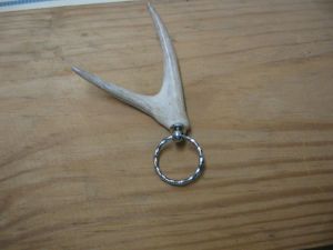

Just figured out how to do the picture thing. This is one of my antler tip keychains turned on the lathe.
This one will go for$12 to $15. Any one interested in seeing my setup for this, just let me know and I will take some pictures.

Where do you get the ends you are using on the antler leftover pieces for key rings?
I use all I can ,to make pens ,starting at the base and when it gets ify on drilling, I make a keychain ,out of the tip, some are singles ,some have the fork as in my picture.

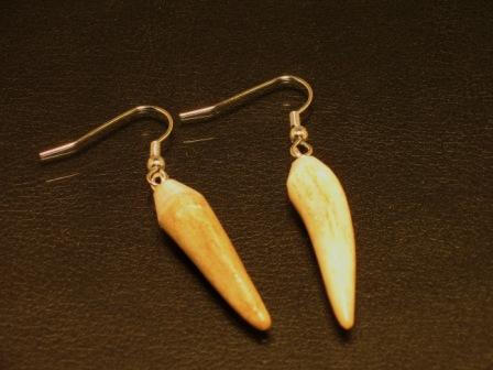

Ryan, It took a while to locate the photo but here`s another item that can be made from antler tips. That`s right earrings.
It may seem a bit strange but I made 3 sets the first go and sold all three sets to the first person to look at them. In all I`ve sold about 10 sets.
Sorry about the bad photo.
