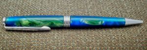

I visited Charlie today and we tried out one of his custom molds. Here is what we came up with. Alumilite & Pearlex. If you double click the image, you may get a larger photo.

Beautiful, really pretty. The thing I wonder, does Alumilite shine up like PR? Up by the cap it looks a bit less shiny. It could be the pic, but I've heard and read that Al. does not polish up like glass, which PR does. Not a criticism at all, it's a lovely creation, just wondering in the event I ever play with Al.

The photo isn't the best. Still working on it. The shine isn't as good as it can be. I find that although it hardens quickly, it shines better after a day of post curing. Maybe it's me, but it seems that way.

Alton did most of it, I just helped mix. It was looking terrible at first, then better, then
better still. He was taking it home to finish since we ran out of time.
Alton had some neat metallic powders but this was the first time mixing anything in
Alumilite. I think we needed to wait another minute before pouring the second and
third color as they tend to sink to the bottom. I guess the bronze powder was too
heavy.
