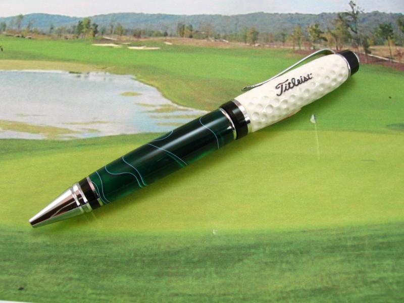

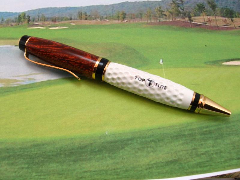

The Golf Ball pan

Wow. How did you do that. Did you skin the golf ball and cast it or what. That is the slickest new pen idea I've seen in a long long time.
Wood Butcher
Local Chapter Leader
Jun 8, 2005
970
Westfield, IN, USA.
Thanks boys and girls for the kind words. The "ball" part is white polymer clay. After seeing and making the baseball and football pens I thought, why not a golf ball? It took a while but I figured out that it had to be done by hand rather than a mould, or at least for me it did. I turned a 1/2 x 1/2 strip of Corian to form a "dimpler" and had to redo that several times before the size was correct. I cover the brass tube, that's been sanded, with the PC, roll it smooth and then, wearing magnifier glasses, I start dimpling till it's covered. Takes between 150 and 160 dimples. I do it in rows radially off setting like bowling pins are lined up. I put it on the lathe and apply 2 coats of thin CA and when dry apply the slip off decal. I let it dry overnight, cause it was getting late, and then apply 4 or 5 more coats of thin CA. No sanding or buffing, just the CA. It came out just as I had hoped (after 4 days of doing it and tearing it off and doing it again). Give it a shot. These should sell but be careful with the trademarked names you use.

Forget trademarked names, think "gag gifts":
"A ball you won't lose" comes to mind.
Oh---Great idea and nice execution, Bill!!!!

Hi Bill,
As a golfer, golf club maker and a pretend pen maker, I salute you.
Awesome pens. Very creative.
I heard of Balata cover, Surlyn cover and so on. But not Poly Clay cover. Just wait and see how soon the big golf ball manufacturers like Titleist, Nike, Callaway, etc get a hold this new material.
PC cover golf ball gives you greater distance, more control, less spin and more spin at the same time. :biggrin::biggrin::biggrin::biggrin:

Great idea and very well executed. How about doing one as a "Euro" pen and using the golf clip pen clip(s) that they sell? Bet that it would look great and be a big hit on the links.

GREAT idea and excellent execution! You could even use the laminated wood from the head of an old driver to make the top portion of the pen. Either way, great looking pen.
Perhaps you should consider going to some of the pro-shops at the golf courses around where you live and I've sure that they would sell like crazy.

Nice job I actually had this idea and tried doing skinning a golf ball but as you found out that doesn't work. You know the core of the golf balls make great segmenting material and turns great and just about every ball I cut open is a different color there a very hard rubber and turn well. I also chopped up the old persimmon wood clubs and used the laminated to make pens with the golf ball core laminated in them. The golfers here love them.
Great job thanks for sharing. I got to start playing with clay. Just not enough time in a day
