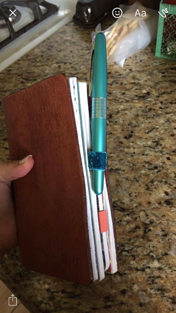

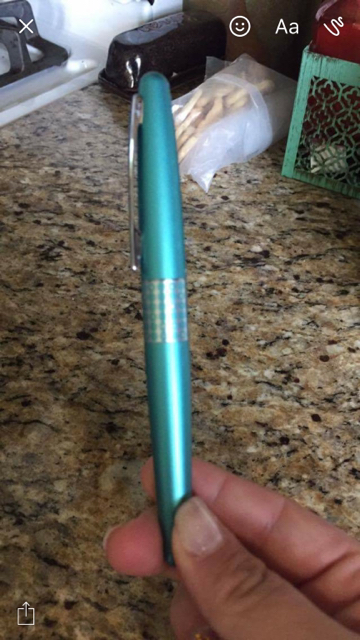

I have had someone ask if I could make a very slim fountain pen, but I can't find anything to fit her needs. I am attaching a pic of what she has now and a pic of what she needs to be able to do (even the one she has is thicker than she wants). No fountain pen kit I have been able to find is this thin. With all the experience in this group, does anyone know where to find such a creature?

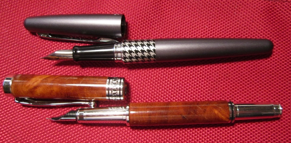

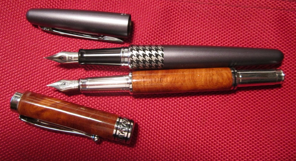

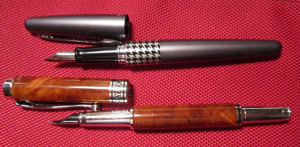

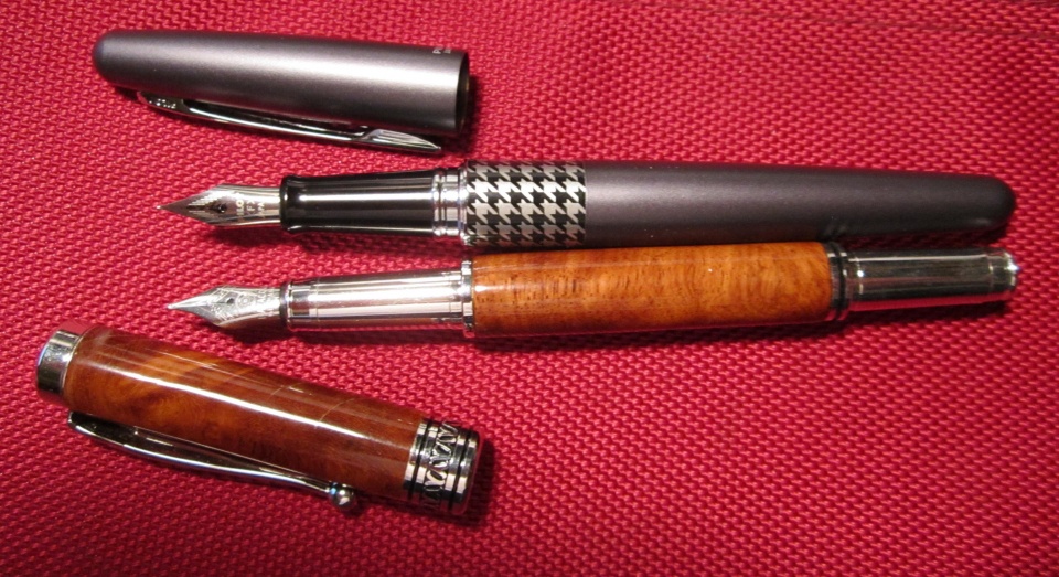

The pen is a Pilot Metropolitan. I have one on my desk in grey. Pulled out my Navigator and the Diameter is pretty close. If they like the rounded ends go with a Sedona. It the same kit but with a domed cap Finial and body end cap.
