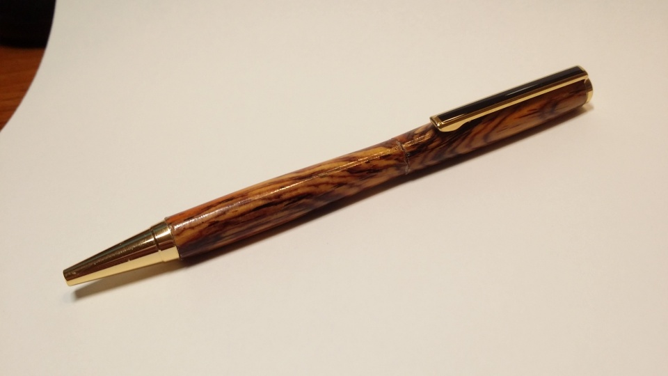

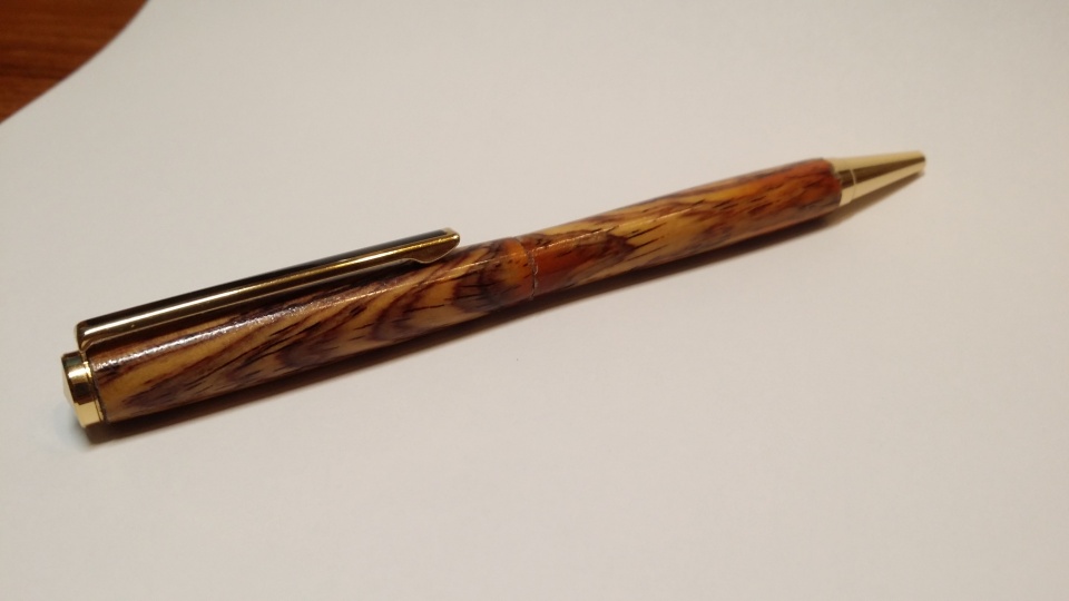

I am new to the whole pen making thing and am reasonably ok with the turning part but am really struggling with finishing. I was working on a pen yesterday to submit to the Turning Challenged Contest as I know I qualify and I just can not enter it as the fit and finish are just horrible. This is only my 8th pen and some of those came out perfect, I just dont know what I am doing right or wrong.
I have posted a couple of pics below and you can see that one of the issues is with the CA finish chipping on the edges. I guess this is due to the way the CA also goes onto the bushing and then snaps off when you separate the blank from the bushings.
I did previously try with some of those little silicon cones and the issue then was the CA getting on the ends. When I tried to sand the ends clean it also broke some of the CA off the edges.
FYI I have been trying either straight CA or the BLO/CA method. I find the BLO/CA easier and like the look but they issue I have then is that when I sand/polish with those little colored micromesh pads it seems I am sometimes going through the finish. The results are really inconsistent and I would love to know why sometimes its fine and others not.
As far as fit is concerned I believe I am turning to the bushings but then I sand and some more comes off and when you add the CA finish it does build up somewhat so how does one make sure you end up with the appropriate diameter to have a perfect fit with the kit parts.
I know I am new to this but would love to figure out a process that I can work on learning and get reliable results.
Thanks in advance for your help.

My method is pretty simple for CA and it seems to work. I sand as normal and use DNA to clean the blank before application of the CA. I use non stick bushings and use the Blue shop paper towels from WalMart cut into 9 strips. I only use the thin CA and apply it to the paper towels and smooth evenly at 500 RPM, with each coat I switch directions and apply the opposite way than the previous, spraying with an accelerator between each coat. When all 9 coats have been applied I will take the blank off of the non stick bushings and clean up the ends with a little bit of sandpaper usually 600 grit laying flat on the table and moving the blank in a circular motion until it is flat. I then place the blank back on the original bushings and use "0000" Steel Wool to sand it down lightly. That's if there are not any bad spots. I then use a buffing compound from CA to polish up the blank until you reach the desired shine. This works for me, and if you ask 5 different people you will get 10 different answers. Hope this helps and is not confusing. Also you can do a search for CA finishing and you will find lots of answers. Good Luck!

Hi Jon,
Developing a good finishing technique can be one of the most difficult parts of pen making. There are many options & techniques and my best suggestion is to read about and study other's techniques, find one or more that you like, then practice, practice, practice. There are many threads here and even library articles on various techniqes and there are lots of YouTube videos on the subject.
One thing you might try is to turn some scrap wood to a round shape between centers (don't even bother drilling a hole), then practice applying a finish. If you don't like the results, just turn it down a little farther & try again. You can make many trial & error efforts on one piece of wood this way.
As far as what you are experiencing, my guess is that your CA coats might be a little thick, so you might try reducing the amount that you use on each layer.
For what it's worth, here's my CA technique.
I turn, sand and finish all at high speed - about 2000-2500 RPM.
I sand to at least 600 grit (sometimes up to 2500 or 3200 depending on the wood). Then I burnish the wood with a pinch of the turning shavings. Then I wipe the whole thing really well with denatured alcohol & let it spin for 15-30 seconds to let it evaporate well.
At this point the wood is quite smooth and I can go several routes -- sometimes I just give it a carnauba wax finish with a white HUT bar, sometimes I use friction polish & sometimes I use CA or some other kind of finish like CraftCoat.
When I go with CA, I simply fold a piece of white Bounty select-a-size paper towel twice, with the back side exposed and apply just a couple of drops of thin CA to the towel. I then wipe it back and forth over the blank, rapidly, 3 or 4 times. I let it spin for about 15 seconds, then repeat with another coat. I usually repeat this 4-6 times, depending on how it looks.
Once I decide to quit applying CA, I let it spin for another minute or two, then I hit it with a white HUT bar, then buff that off with a wad of paper towel.
This is not a high-build CA finish that some people like. It looks more like a friction polish finish, but usually a little shinier and (so far) it appears to be a little more durable.
Personally, I don't particularly care for the "encased in glass" CA finishes. I like the look & feel of wood and if I want a blank that looks & feels like plastic, I'll just start with an acrylic blank in the first place. That's just me though - other folks have different opinions and that's fine too.
The thing that I do like about my technique is that it is extremely easy and quick and almost foolproof. Just get the wood nice and smooth to begin with and you don't have to do any further sanding after applying the CA finish. Applying and buffing the carnauba wax topping while the CA is still a little soft helps to smooth things out and enhance the shine.
This is just one technique and I don't necessarily recommend it over any other. It's just one that I've stumbled onto by trial & error that I find easy to do and gives me consistent results that I'm happy with.

If you're using a good quality CA, you can go from a satin to high gloss finish. The satin still feels and looks like wood, while the high gloss is more like polished glass. Again, if you're using a good quality CA, you won't need much. I've found that most people apply far too much at a time and end up with lots of swirls and ridges that have to be sanded down.
Once you get to medium CA, just use a tiny amount - 2-3 small drops are all that's needed per pass and just a few coats. Globbing it on will only cause problems. Once you're done with the CA you should need very little follow-up sanding. For that sanding, I've found that Abranet blows away regular sandpaper. Then, just some light polishing to whatever level of luster you desire.

You might try using BLO (boiled linseed oil), apply it to the blank spinning on the lathe and while the paper towel is still wet add a couple drops of thin CA and rub it back and forth quickly to even it out. Careful the towel will get hot. YOU NEED GLOVES! This is called BLO/CA finish. It is not new and I learned about it on this and other sites. Try 6-10 coats and it should only take 5-10 minutes to complete a blank. It will look like wood, retain the grain and pores yet be protective. The shine is somewhat soft luster which can be very nice.
I did this to five razor sets with brush, razor and stand today and they look and feel great. My personal razor is two years old, gets used a lot and still looks and feels great. One of today's shaving sets and a couple of razors.

If you are having problems with the CA breaking off, score the joint with an exacto or utility knife while turning the lathe by hand.

If you do not like the look of highly polished CA, polish to 12000 with MM and then work your way back down the MM until you get to a level of polish you like. You will still have the protection of CA. All the friction, oil or wax finishes are not durable enough for regular use.
Why put all that time and effort to make something nice that is not going to last.
As far as the fit, are you using a caliper ( Dial or Digital) to accurately measure the diameters of the pen parts and the blank as you turn it and finish it? If not get one.
You cannot turn the blank to match the pen and then expect to add more than a couple coats of CA and have a good fit you need to turn the blank at the business end to slightly less and then add the CA, hence the need for a caliper.
Thin craft foam works fantastic for applying THIN CA to the blank one drop at a time. This will keep you from applying too much CA at a time. After 5 coats lightly sand it to see your coverage, add 5 more coats sand and polish.
Use a razor blade to score near the end of the pen before removing blank or remove the blank every five coats of CA stand the blank on end on 320 sandpaper moving it lightly in a circle to remove the CA hanging off the end of the blank.
