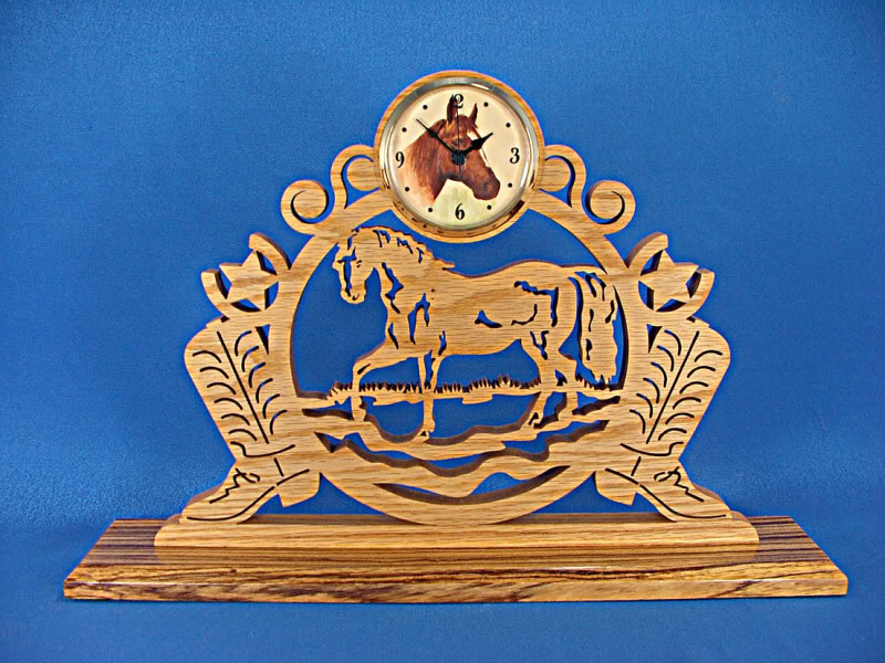

Sooo? this really has opened up a big can of worms. If the nostalgic or (old school look) and feel, is what one is after in a pen. Durability from everyday use, wear and tear will suffer in it dramatically. I guess I need to explore other finishes. Can you guys lead me to other applications CA or Poly, Satin or Gloss? Stains etc.
I have boo-coos of Red and White Oak and they are beautiful. I just need to develop a finish/stain for them, as they are native woods to N.C. This particular project is a pen that I am going to give to the Pulmonary Surgeon that saved my life last August, and I really don't think that it is going to be something that he would want to use everyday. Not that my work is a museum quality instrument LOL! But, I think he will hold onto it because he is a very fine person IMHO, but you never know.
