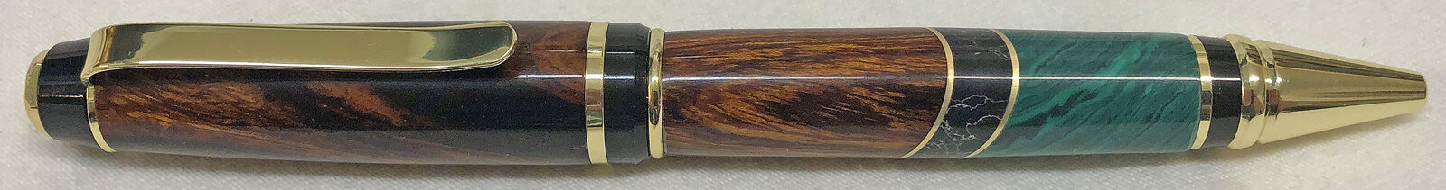

Lignum vitae does make a nice pen, and as others may have already commented, a finish like Pens Plus seems to work better on it than CA (for me anyway). I typically use it when I am going for a historic or technical aspect as I personally don't find Lignum Vitae particularly attractive.
Coming in just a little lighter than Lignum Vitae however, is Sonoran Desert Ironwood which is one of my very favorites when it comes to color and grain variations. I have also had very good luck finishing it using my standard CA regimen.
Make sure to use a heavy kit to start with. One of my favorites in that category are the Cigar styles. One of my every day carries is a gold Cigar made with a segmented blank of Malachite Simstone and Sonoran Desert Ironwood. I would definitely consider it as being heavy. (pic below).
