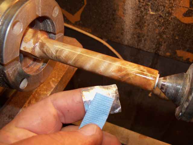

Well, while the OP poster was requesting help with his CA finish, he certainly had plenty of that and no point in me adding my CA applying system to the already large list of possibilities, mine is a straight CA with accelerator between every coat but no BLO...!
Anyway, the other very important issue that keeps coming back in this thread and so many others of identical nature, is the fact that, the burn from the CA, or should I say, getting the applicator stuck to you finger to setting stages, is a lot more than painful, it is indeed, agonizing.
I have had it pretty bad with nasty burns and loss of skin, taking days to settle and stop aching...!:mad: I have tried lots of stuff but nothing did work as what I use now and as far as I believe, anyone will be able to find this product to try it out...!
So what is it...??? well, is something that sticks to your glue finger, feels like nothing is there but, is insulates the heat from the curing CA, and stops the glue to go thought.
So, what is this "magic" product...??? now think, what do you know that has the properties I just mention...??? got it....????
That's right, is that silver coated, heat resistant tape that you buy to repair mufflers. Absolutely efficient, very inexpensive, considering that you only need to cut about 1 square inch to cover your finger tip, doesn't affect the holding of the applicator nor the way the CA is applied and felt on application, stays in the finger until you're ready to take it out and most importantly, you don't have to be loosing your finger-prints skin impressions, all of the time...!!!:wink:
Have a go, you will be glad you read this post...!:biggrin:
PS: I have just added the pic of what I meant, I never though in taking a pic of it before but now that the issue come out, here it is...!
Cheers
George
