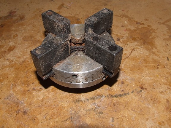

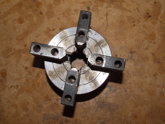

I use this little cgm3 with these jaws... does same thing... plus I have two or three other sets of jaws so the chuck is useful for more than a dedicated drilling chuck..
