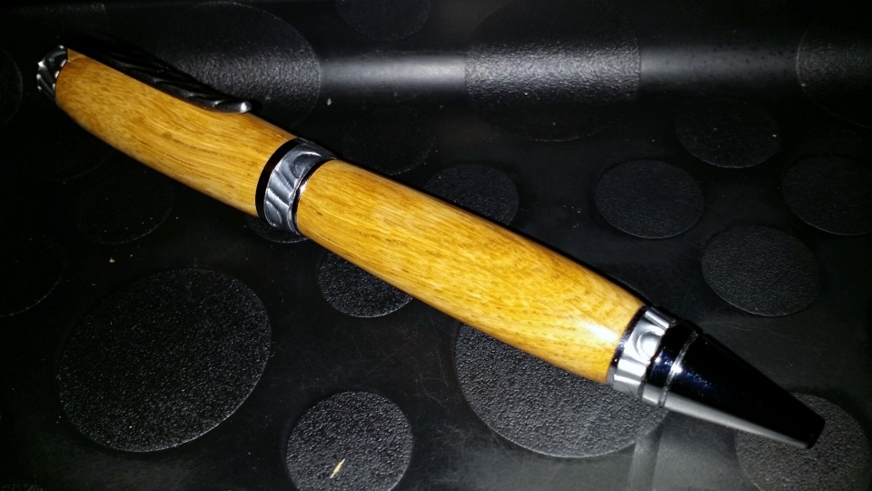

sschering
Dec 23, 2009
382
Eugene, OR
I'm happy to report it works well in a oil-ca finish..
It's a Ultra Cigar twist pen in oak..
