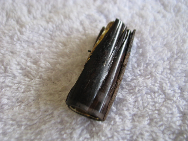

The only problems I've had with ebony were using some that wasn't fully dried yet. It cracked right down to the tube. :frown:
But when I'm using some that's been properly dried, I'll wipe it down with denatured alcohol before starting on a normal CA regimen. Agree with the sharp tools and go easy with the sanding. Heat is especially your enemy with ebony.

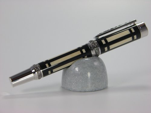

I have to disagree with this statement. Gabon ebony is an expensive exotic wood and is used mainly as accent woods or in combination. You put that against acrylic and you can see the difference right away. Here is an example of where I used with Holly. Now there was no way I could sand that blank and not contaminate it. I could not wipe it down with acetone or DNA. I use a sharp skew and there is no dust. I go right from tool to CA.
In all facets of life there is a thing called "Smart Money" Money well spent and that would be the case for a dust collector. The price of hospital stays and treatment will well surpass the cost of a collector. A hobby is something you enjoy to do and to continue doing it, you have to work safe.
