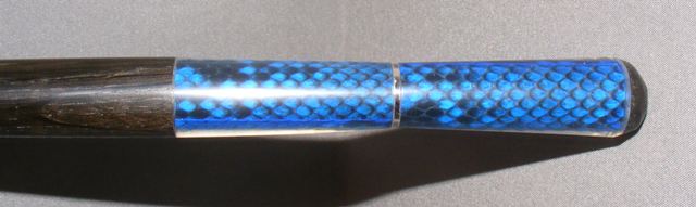

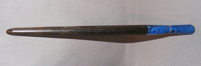

I present the first "Dragon Slayer's Wand"
When I was making a couple wands recently, I started thinking about how a wand with a dragon skin (snake skin) handle would be awesome. Since I had a couple sets of Glimmerzandmore's Cigar snake skin blanks, I thought I'd try adapting them to my vision. So I got a piece of Bog Oak (it's gotta be the best wood for such an impressive wand) that's about 5 inches long. I chucked 1/4 inch in and with the other end supported with the live center turned a dowel. I snuck up on the final diameter of the inside of the brass tubes on the blanks. Then I drilled a corresponding hole in the end of another 10" piece of bog oak. I use GG to glue the tubes and a centerband trim ring from a cigar and the shaft all together. I turned the profile all at once leaving just the tip and but to finish afterwards. The tip and but were finished on the disc sander then polished with a buff of EEE.
While the handle a a touch shorter than I'd like, I think it was a successful experiment. What says you guys?

Awesome Mike. My daughter was looking over my shoulder when I zoomed in on the photo. Guess What is on my "to-do" list now...
GoodTurns
Apr 20, 2007
4,125
Bowie, MD, USA.
methinks you've made a winner...I have a couple of "half sets" of snakeskin blanks that I got from a friend who blew up the other half of the set....they would work as a centerband following your lead...just a longer butt on the wand below the band...
nava1uni
Mar 30, 2008
4,936
San Francisco, CA, USA.
Now you just have to see if it works it's magic since Dragon skin must surely have special powers. I bet Harry Potter would like that wand. I sure do!
