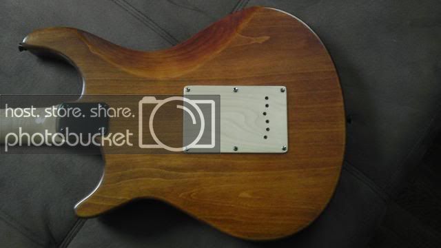

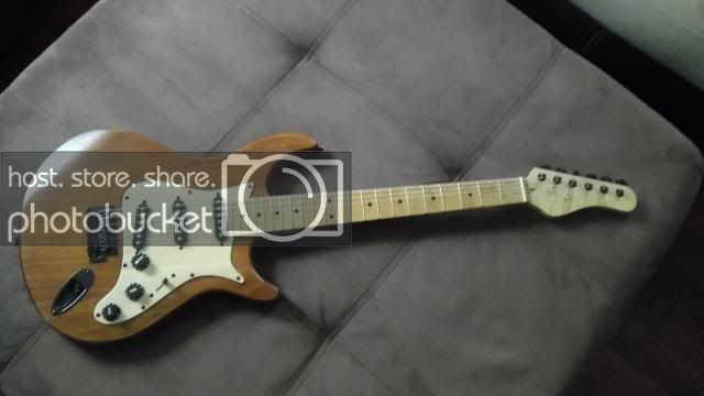

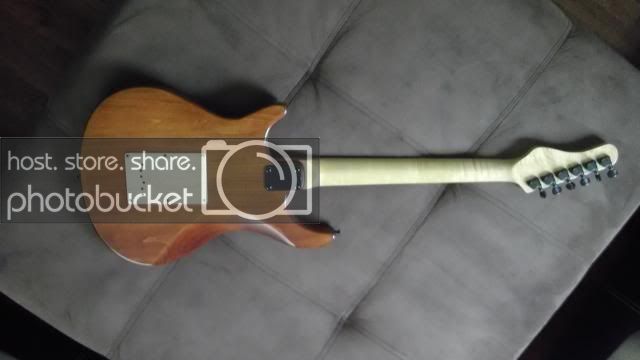

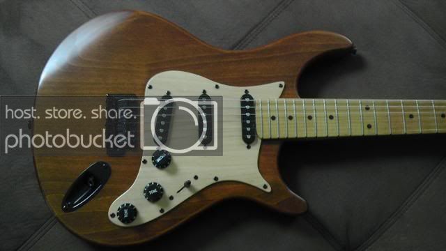

another option would be to buy used electric guitar, pull the neck off (4 screws and the hardest part to build) and build a new body using the donor guitar as a template for the routing out and for parts. kind of custom.
This is exactly how I built my electric guitar. It was a Behringer guitar. The neck and frets were decent, the body was plywood. I kept the neck and scrapped everything else after using the body and pick guard to make a template. Used a spokeshave to shape the body (can use a belt sander if you want). Was able to get some fender strat pick-ups on craigslist for $10. The biggest thing I would be concerned with in terms of a kit you buy is the components may not be all that great. Anywho good luck with the build, it is a lot of fun to finally get it all together and plugged into an amp.
