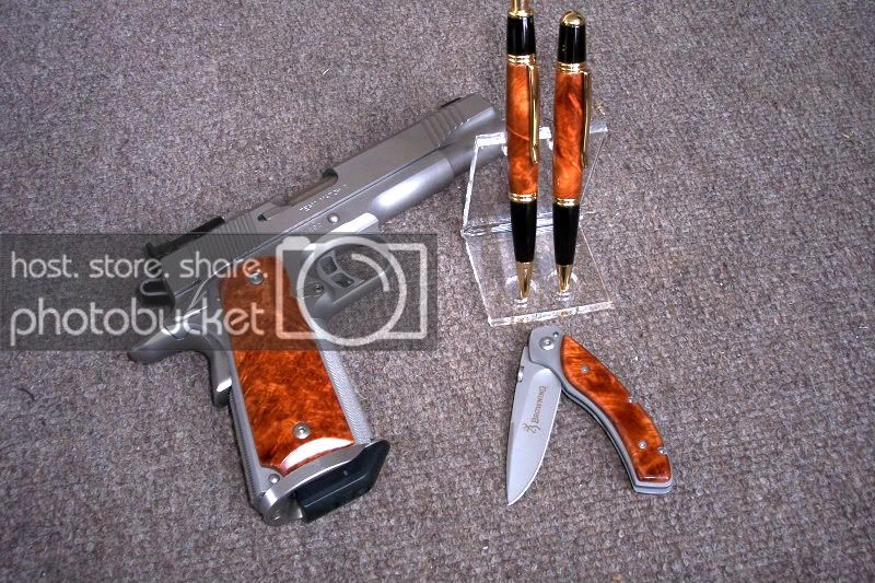

A while back I posted that a gentleman contacted me after buying a couple of my pens and wanted me to make a few things out of Amboyna Burl. He wanted grip panels for a 1911, knife scales and a pen. Since he didn't really want a high end pen I threw in the pencil so he'll have a set. He doesn't want them to use, he just wants them to admire and show off.

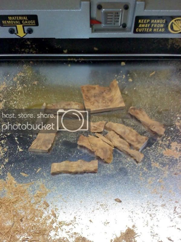

Anyway, it was a learning experience working with Amboyna in something other than a cylinder shape. I found out that since it is a burl it doesn't like to be thinned very much with a planer. :eek:
The knife scales needed to be at least half as thick as they were so I fired up the planer. It had fairly new blades and I only lowered it 1/64" at a time. It didn't care, about the 4th pass I heard this ungodly sound and pieces came flying out.
So much for having a matching pair of knife scales :frown: I didn't dare run the second one through again so I spent a considerable amount of time using the belt sander and hand sanding it down. When Amboyna Burl gets warm it does tend to bow too. They are small enough that the pattern doesn't differ that much from side to side. Because they were so small they took the longest amount of time to complete since the hole placement was extremely critical.
The grips weren't that tough to do but it has been 20yrs since I made a set so I took my time. When I went to apply my finish using TruOil it wouldn't dry. I wasn't sure if it was the oil in the wood or the age of my TruOil so I cleaned it off and applied CA. THAT was a trick to do and do evenly. I made small jigs to hold them but I still managed to glue my fingers together several times.
All in all I enjoyed the challenge but I don't think it's something I want to do anytime soon. It's not a very good picture but the grips and knife panels do have a high gloss finish. The Kimber in the pic is mine, it's a Team Match II in 45ACP.

Thanks for the kind words :) It was a lot of work but it gave me a break from the usual turning for a while. I told the guy I made them for it's something I've always wanted to do for myself and he thought perhaps once I gone finished that it would inspire me to go forward with it. I don't think so, at least not for a while and when I do the knife is going to be larger. Those small knife scales were literally a pain to duplicate. I ground off the tips of three fingernails in the process. They only measure 3" long and 1/8" thick :eek:
The picture only shows one side but the grip panels are a book matched set. I had to buy all of the Amboyna Burl from the same person to get the same color and pattern, then get the buyers approval. I've sent him a couple of pics and just waiting to hear back from him. He paid for half upfront and the balance upon completion. As I said before, it was a lot of fun and certainly a learning experience.

WOW! :eek: Talk about accenting the knife and the Kimber. The pens came out really sharp.
I have that same Kimber and I just may be removing the combat grips to put on a purty set like yours, but only for show of course.

Beautiful work!!!! Did you powder coat the Kimber yourself, or did you buy it that way?
The gun came that way, it's stainless steel. It was a limited run and the same model the olympic shooting team used. That's why it's called the Team Match II. It came in 45acp and 38super. The original grips were red, white and blue and had USA Shooting Team on them. I took them off shortly after buying the gun and replaced them with wooden finger groove grips I made. He'll be putting these grips on a Springfield.
