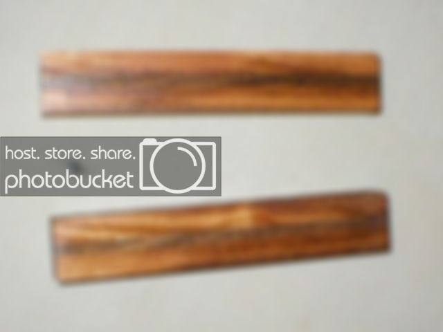

my dad is a luthier and bought a bunch of Goncalo for fret boards. long story short he wasn't thrilled about the quality (coloration wasn't going to match the quilted maple neck) so he gave them to me :)
10 of 'em:biggrin::biggrin:
i usually use this type of thing for overlays in the grip or tips of a longbow (i'm also a novice traditional bowyer) but i decided to laminate them together to make a couple pen blanks. i put a 1/8 sheet of walnut between two sheets of the goncalo with tb3, kinda curious as to how it'll look.
so what do you guys think? is the goncalo a sucky turning wood? should i have high hopes for this blank?
its 2 1/2 in wide at the moment and the glue is drying. I'll try to post pics once its cut and perhaps when its finished, but you'll have to give me a break, as ive been sick as a dog for a week. H1N1 really ain't all the fun its cracked up to be:frown:

mine looks sort of like a tight grained bronzish maple color with random stripes of light to dark brown running through it with the grain, with some character knots as well

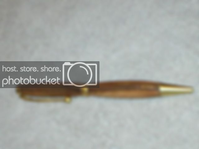

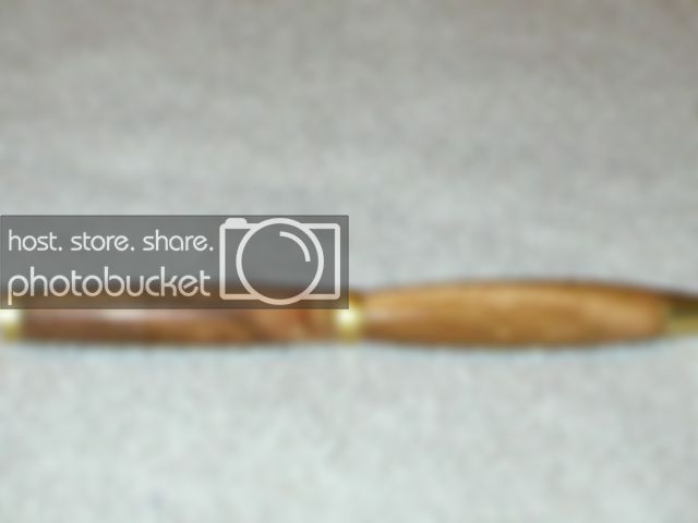

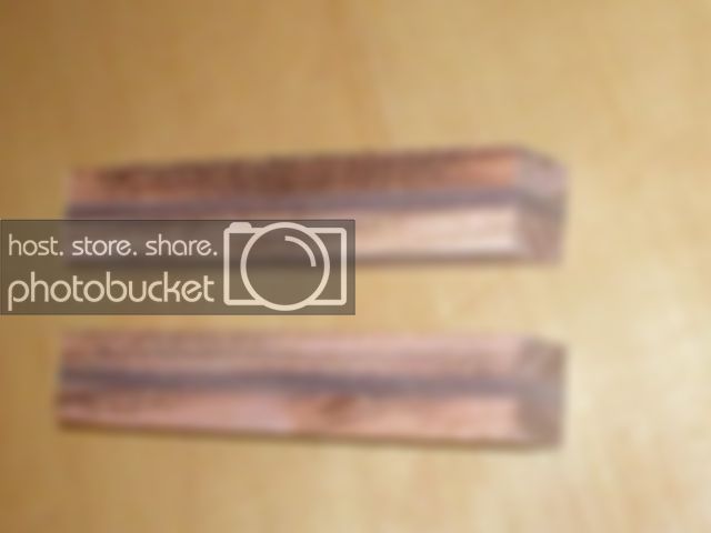

blanks are cut to size-whata you guys think?
Zander
NewLondon88
Local Chapter Leader
May 15, 2008
5,077
Claremont NH
I like it .. turns nicely and takes a polish.

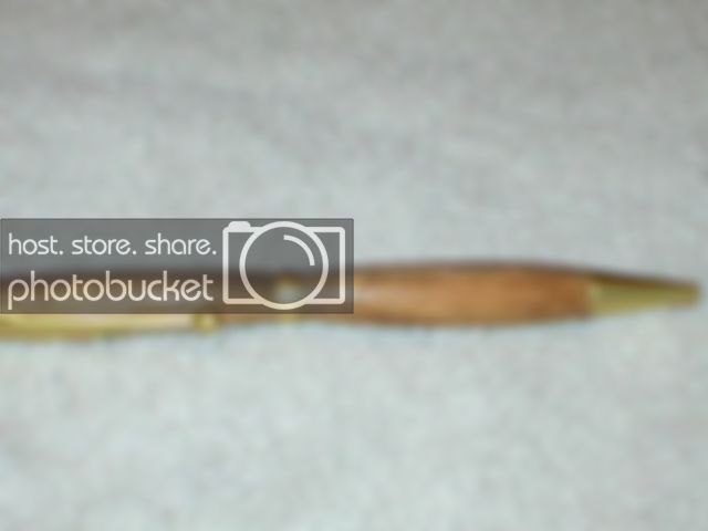

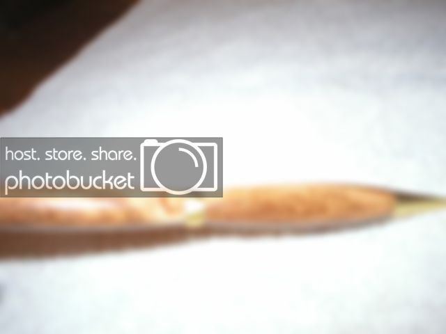

LOL .. close-up photos take some practice. Looks good from what I can see.
There some nice color in those blanks. Good smooth lines..
Let's see more!

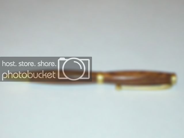

lol okay, here's a cocobolo w/CA/blo 10 coats on a satin gold slim
and a blue dyed curly maple w/10 coats of CA/BLO on a 24k gold cigar
its a brighter blue in real life, and the maple was bought from byron, great stuff. i applied the blue just before the CA/BLO (after drying of course)
this pen is for the person who introduced me to this wonderful site, thanks to a fellow trad archer!

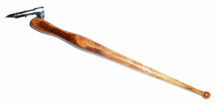

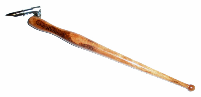

Some places consider the Goncalo Alves with the coloring you speak of as "Tigerwood." (There are a few woods referred to as Tigerwood.) But the place I get this at does call it "Tigerwood." I can be a beautifully turned piece. Its easy to turn and finishes well. This is an Oblique holder I made with Goncalo Alves.
