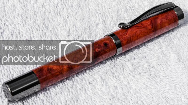

CA does get the job done. However I can't stand the stuff so there are alternatives.
I used minwax spray poly on this pen. The body that is. Worked well.
I layered it by spraying a fresh coat every hour. Approx 6 coats. Cured for 48 hours. Then I used micro mesh to sand it out and finished with a nice buff.
You can achieve a glass finish with wood turners finish as well. Its takes a little more time since you need to build the finish. Maybe 20 or so coats. 24 hours to cure, micromesh and buff.

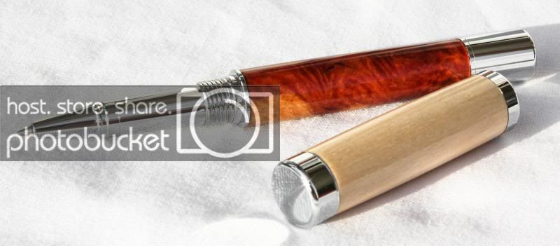

You want a "Glass" finish?
I did the Ultra Cigar a while back using Plexiglass.
Les
