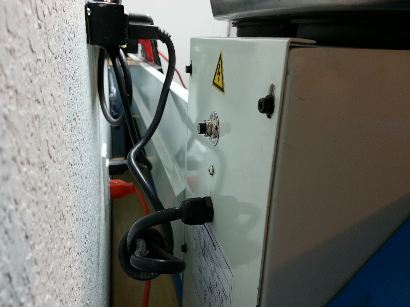

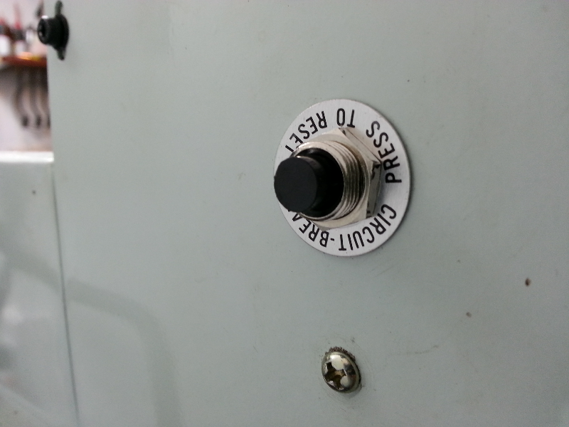

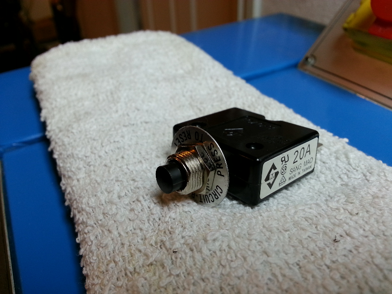

Recently someone with the same lathe had a fuse blow and inquired about a replacement. I did some research and found some different options, either a fuse bulb replacement, the entire fuse block replacement (something you have to replace if you are like me and when inspecting the fuse, have trouble and the block gets torn up), or an entirely new push button reset breaker (rated with the same specs obviously). So I opted for the latter and have included some pictures of the replacement.
